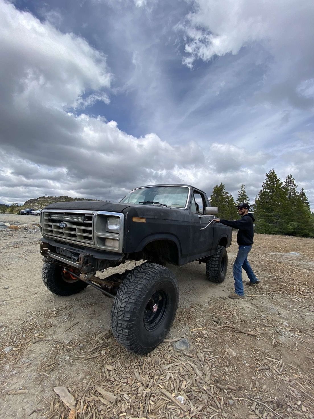

I have an 1986 ford bronco with a 302, I’m looking to do a Manuel swap, a buddy of mine has a T-18 but doesn’t have the right bell housing for me and I’m having trouble finding one. I was wondering it a T-5 bellhousing will bolt time the t-18 or maybe if anyone has different trans options that might be easier to find. Keep in mind it‘s a crawler
