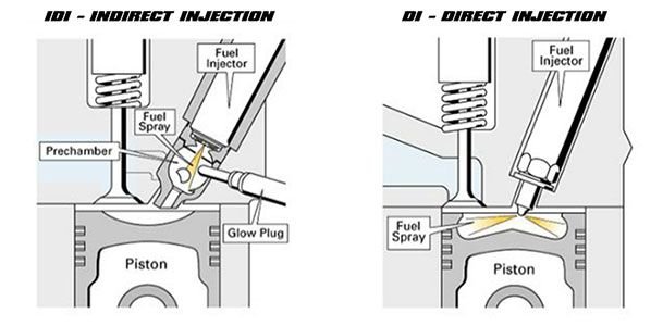

what I mean by "One piece" is that it is still in the place where it should be... not broken off and in the PreCup ... if it is loose in the Precup I doubt you can blow it out.
You can get a bit of access to the GP if you remove the injector ...but very limited... at least you can spray it with WD-40 with the injector removed.... so that is a Plus sometimes as you won't get spray down the threads......
you maybe get the idea from this primitive image... I have better images but this was just a duckduckgo search for just a quick response.............

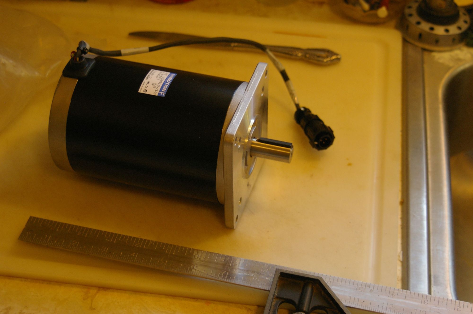

I've been playing with an AR turbo that can deliver 8psi boost with a BLDC motor using 96 volts
this motor has been rewound with custom winding and can hit 20K RPM possibly higher but my controller starts crapping out around 24K.
anyway it's fun to play with
