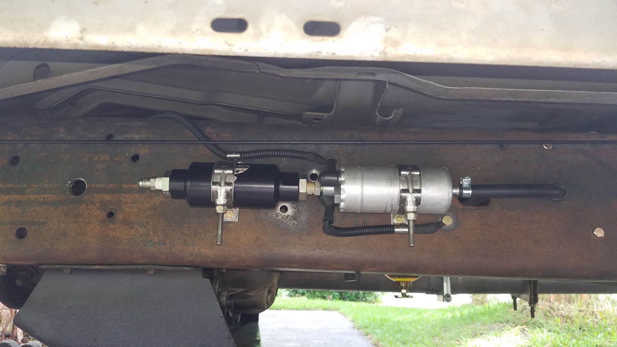

Convert to Superduty electric pump and ditch that ******* in the valley.
Much better addressed in the 7.3 sub forum though.

Data logging would help narrow down the focus area(s).
If you simply want to throw parts at it, as CarterKraft mentioned, converting to an efuel solution will not hurt anything other than the wallet. There are many different paths to go from picking parts from a SuperDuty to a complete kit.

E fuel is great. Buy once, cry once. Future pump swaps are easy with it here.... Stock SD pump is readily available and reliable.
