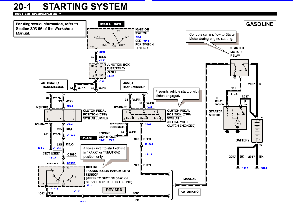

I also currently have a bypass button installed in the dash to bypass the ignition switch as the Key won’t start the vehicle.
I had a working Ignition module so I swapped it out, didn’t change anything still no start. Had an extra ignition switch/key swapped it out still no start. Plugged my switch starter into the relay and can turn over the engine from relay.
my assumption is either bad TRS or Starter Relay?? What do you guys think??? I’ve already replaced the BIG 3 and touched as many grounds as I can throughout the vehicle.
im thinking of just replacing both the starter relay and the TRS. The other day it was shifting hard between gears then it magically went away.

interesting, I’d do a couple of checks and start ruling stuff out. Big white is a 99 F350 5.4L 4x4 Crew Cab Long Bed.
grab a multimeter and check your battery, battery voltage. Make sure your battery is still good, after that check your starter it’s easy to bypass/cross the starter relay on the fender wall by the battery. It’ll tell you if your starter is bad or not. There’s a signal wire that runs into the starter relay that you can check and make sure you’re getting signal from your ignition switch you’ll need a second set of hands though.
thatll give you a check off of Battery Starter, starter relay then you can check the ignition module/switch under the dash. Depending on the model it may be a security issue with the key from what I’ve learned/understand.
so as a step by step, make sure the battery has enough juice/ check battery connections and main grounds. Battery voltage is low charge battery or have it tested replace and clean all connections.
Cross fender mount starter relay located by battery, if starter doesn’t engage most likely bad starter. If starter does engage most likely bad relay. However also pull a volt meter and following the diagram below 12V check the little T/R wire the signal wire from the ignition switch. Have some turn the key to “start” while you check for 12V at the signal wire at the relay.
if signal wire has 12V then replace relay, if signal wire does not have 12V next culprit is most likely the ignition switch/module under the dash. Easy to get to just take the panel for the interior fuse block off then there’s a couple hex bolts on each end but why you’re looking for is a tan/vanilla looking rectangle with a jolt in the center. Unscrew the bolt and then remove the wiring harness and replace. I’ll post a picture of what it look likes below as well
let me know what you’ve already done or if this helps at all or if you have any other questions!

Shoot I forgot, my mileage is 45k miles! My starting issue was a combination of bad Starter solenoid/relay and ignition switch/module.
when I wired in my push button start to bypass everything I had also shifted around some wires that needed moved back correctly which didn’t help with my wire track downs at the time I had forgotten that I had done that 😂. As soon as I disconnected my push button wire in and ran my wiring back correctly I was able to track down the faults in the system quickly.
Just as an Add in. I installed a home made push button start as I initially traded a running 1997 Mazda B3000 2WD single cab straight across for this truck and the 99 wasn’t running and it was dead of winter and needed a truck on the road. So I took all of 5 minutes to run a couple wires and drill a push button in the dash to bypass everything.
but the base model ignition system on these trucks are very simple and easy to diagnose by just checking one thing off at a time.

Batteries will get a couple bolts back if they just sit overnight and then will quickly die out again. Sounds like your battery isn’t pushing enough to turn the starter. But it’s a possibility the starter is stuck as well.
if start by making sure your battery is charged and then you can check to see if she’ll turn over then.
you can grab the battery and run it down to NAPA and have them test it. They should have a charger that’ll tell you if you have a couple dead cells. It’ll be a couple hours for them to tell you. You can do the same with the alternator they should be able to load test it for you.
to remove the alternator
1.) release tension on the belt using a 1/2” bar on the tensioner arm, and then move the belt off the alternator. Be careful not to let the belt come off of the other pulleys the alternator slack.
should test nicely on the fan pulley right below it allowing you to keep the rest of the belt on track.
Rule of thumb take a mental picture of how the belt is running as well invade it falls all the at off.
3.) remove x2 10mm bolts from lower alternator
3.) remove x2 10mm top bolts from alternator be careful not to loose these studs.
4.) unbolt positive cable connection 10mm as well
5.) disconnect the 2 wire connections
install is reverse unless you you get a new alternator without the pulley in which case grab a 1” socket and an impact pull the pulley off the old alternator put it on the new.
Also be a good time to inspect your accessory drive belt for wear and tear check for cracks, fraying and burn marks and make sure your alternator is receiving correct belt tension.
to me it sounds like your battery is dead, a battery dying while driving the truck sounds like you have a bad alternator. I’d take them out and get them both tested it’s usually free to have them tested at the big brand pets stores.
i just replaced the alternator in the 99, went to drive around the block headlights got dim, radio turned on and off, dash lights got dim, a bunch of warning lights kicked on. Got it back to the house and let it sit outside and idle with the headlights on to see if my assumptions was correct eventually the engine died on its own sitting. Let me know I wasn’t getting current flow and the alternator was bad.

Good evening. As I had said earlier, the NAPA battery is brand new, 2 weeks old. It was reading 12.38 volts right after I got towed home. I may have left the key on however overnight Friday. Im not sure. I placed my 10amp charger on it overnight Sat and all day today and its reading 10.20 as we speak. Imtaking it to NAPA tomorrow and seeing about a new alternator at the same time. My multimeter is cheap. The solenoid is not expensive so Ill check into that as well. That still doesnt explain however why the speedometer went to zero on the way back home??? Weird?? Ill let you know what I find out Thanks for your input
Update. Just got back from NAPA, battery is reading 13.8 on their tester. The solenoid is $26 there, but I havent located it on the truck. It is not on the passenger fender as I had thought. Wanted to jump it to see if it is working before I keep throwing money at this issue.
Update no 2: Just finished cleaning really good all connections at new battery as well as connections on solenoid which is on the starter btw. Cleaned all ground strap connections to the frame. Fired right up and ran good. Speedometer is working again. Glad I didnt start replacing parts. Didnt cost me a dime. !! Thanks for your help tho
