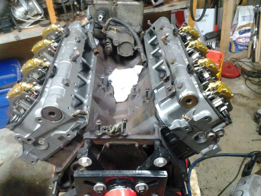

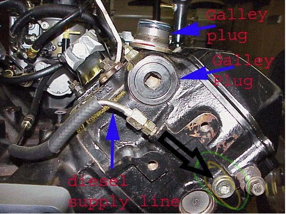

I don't have a labelled diagram, but maybe these pictures will help.

The red arrow is the fuel rail plug.

thanks for the input, yes that's the culprit. Looks like it will be real fun to access.

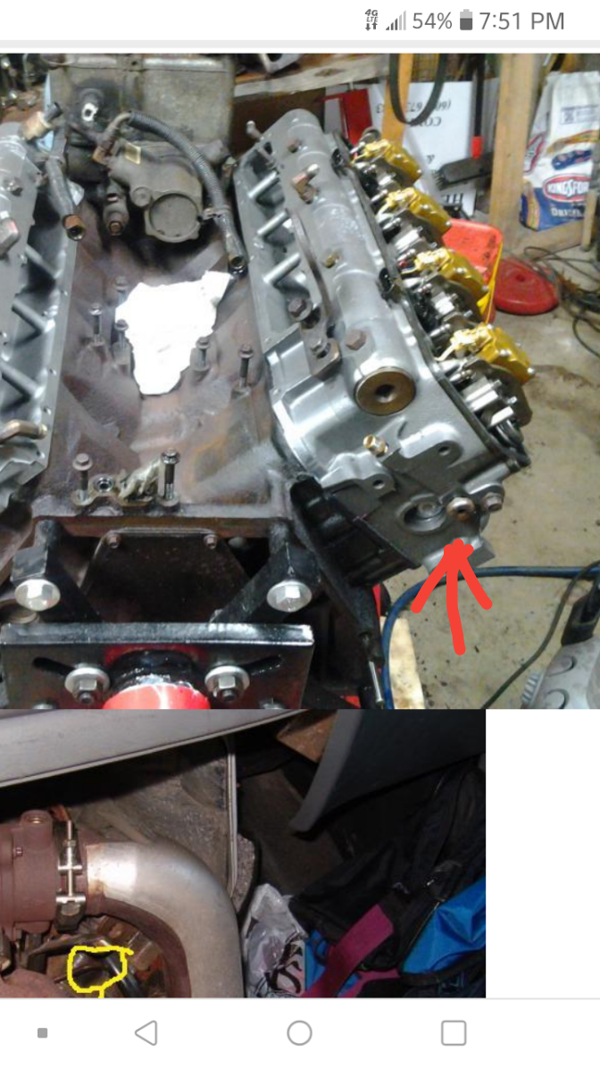

leak marked with unlabeled arrow
pic added for reference
