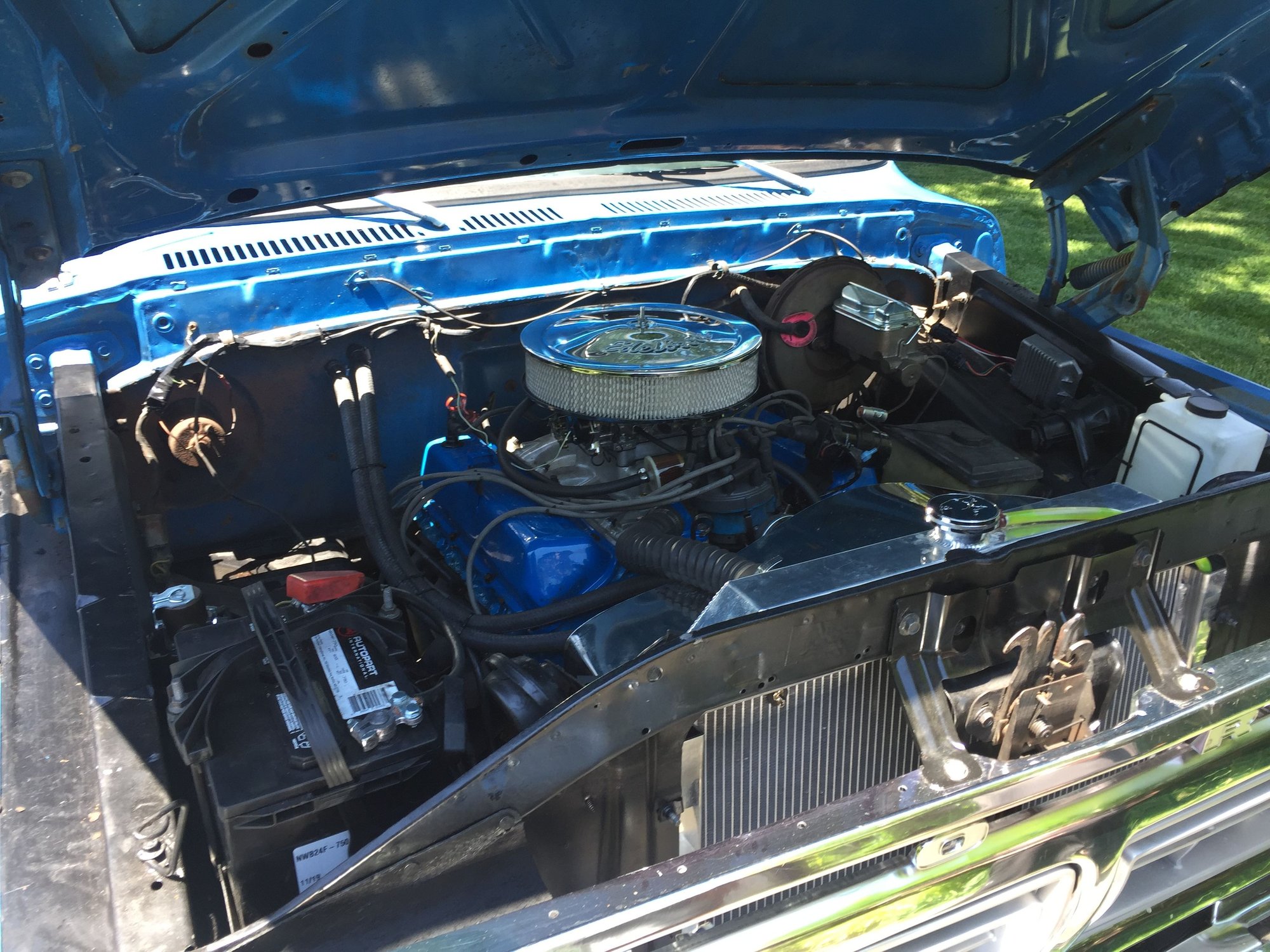

Hello everyone, just completed a rebuild of the original 460 in a 1977 Ford F250 Ranger Extended Cab Camper Special. The mechanical fuel pump doesn't seem to deliver enough fuel to the new carb, so we installed an electronic external fuel pump (Summit G3136-1) and it does what its suppose to and the engine runs great. But I am disappointed in how extremely loud this pump is. Disapointed because it distracts from the new magna flow exhaust we installed.
Does anyone have any advice, or can recommend the quietest external fuel pump. Mounting within the tank not feasible and there are two tanks, 1 main in the rear and one aux side mounted tank, so the pump unit is mounted on the frame forward of the switch valve about midway under the truck.
