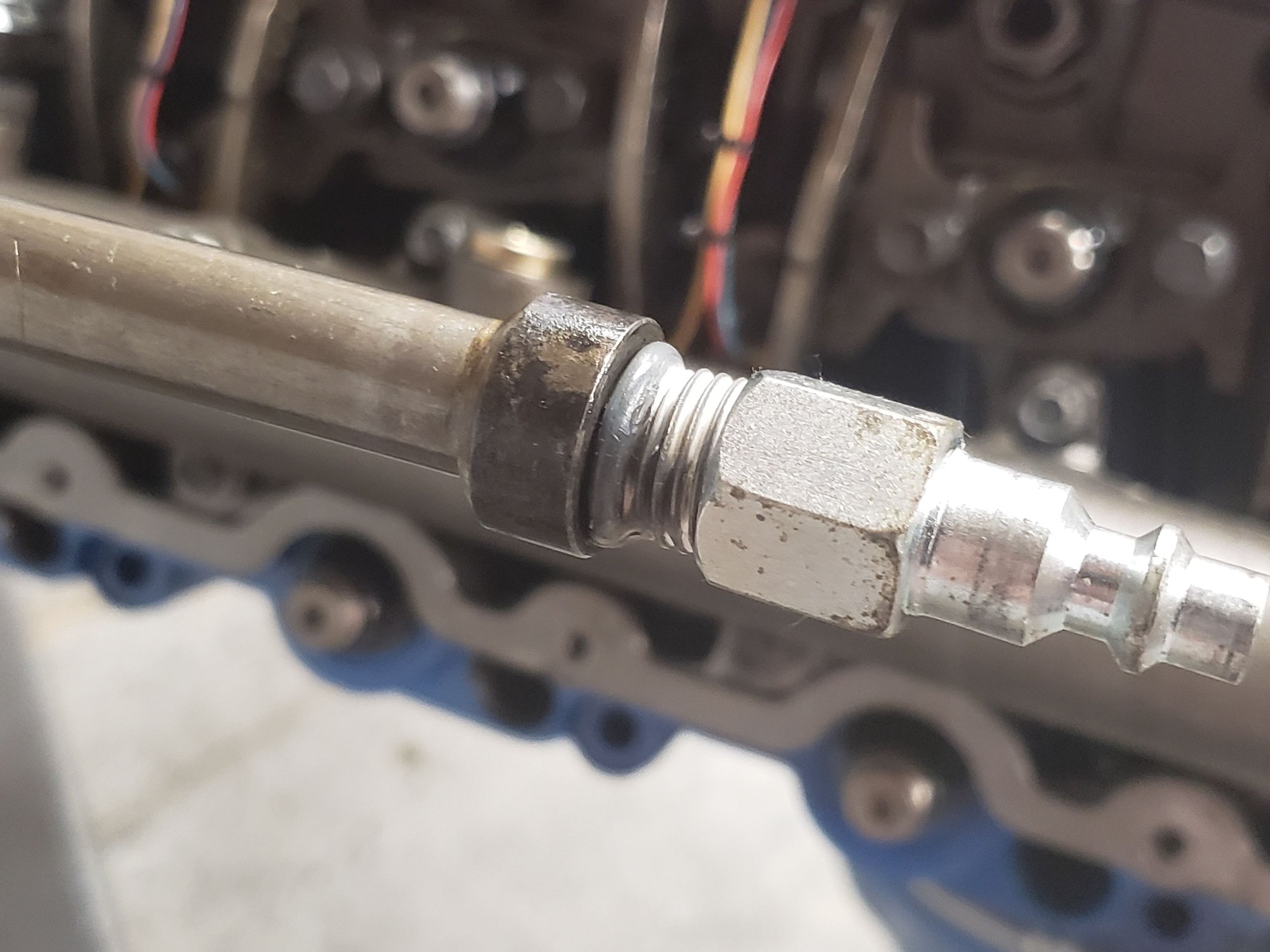

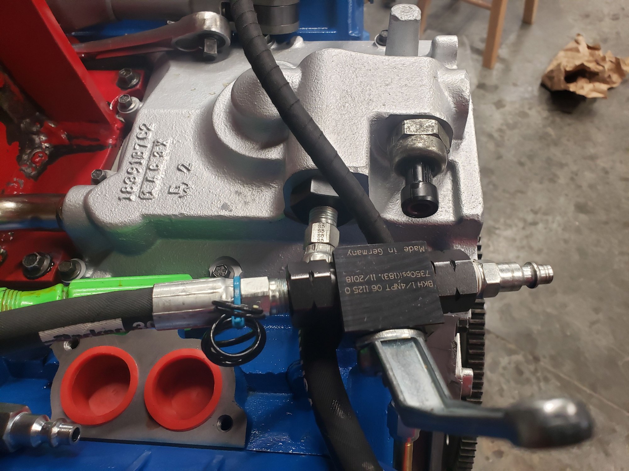

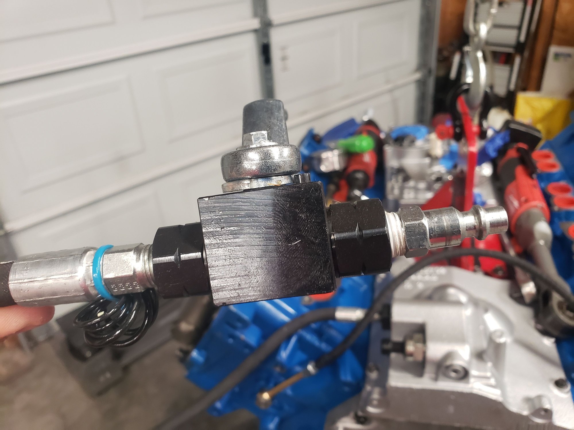

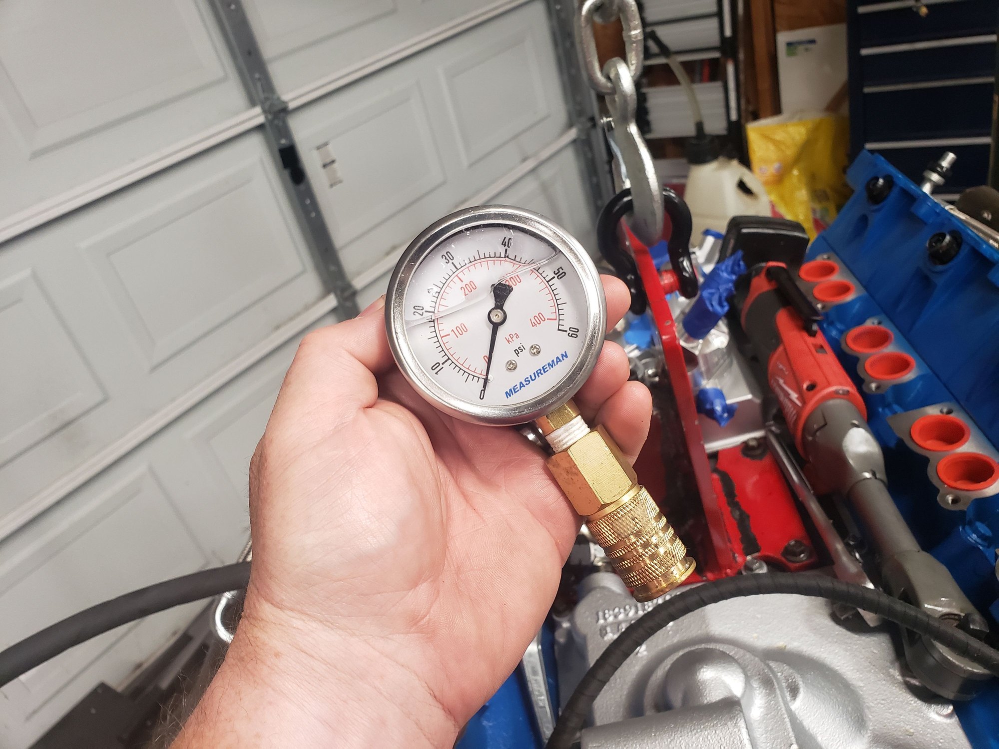

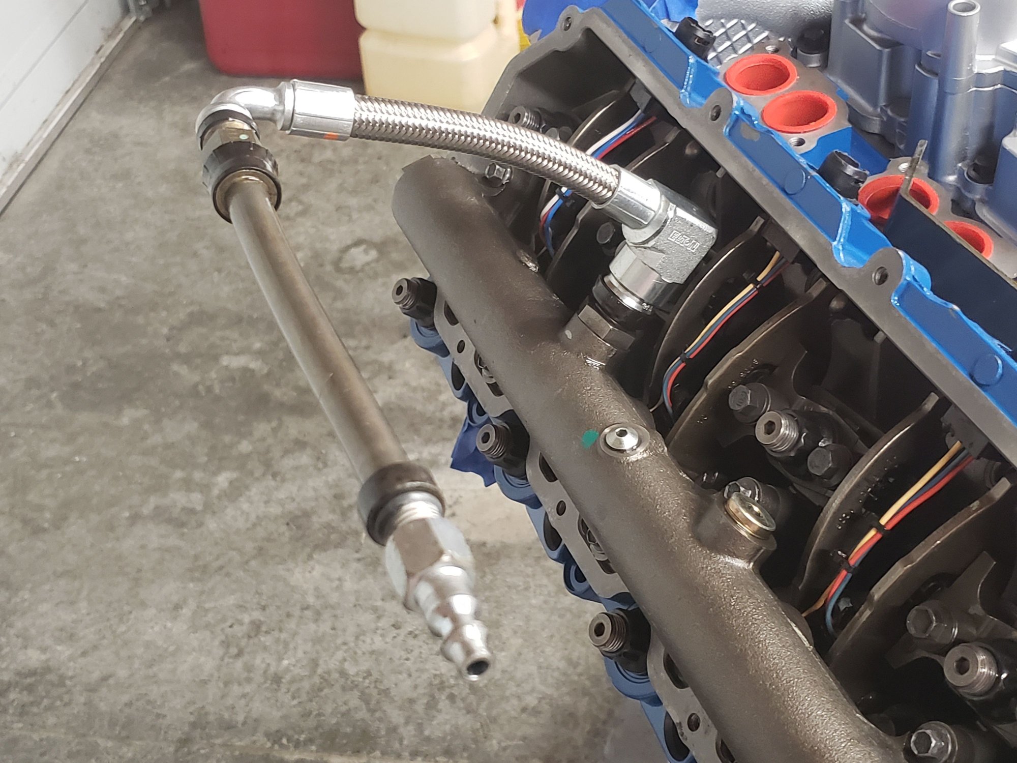

dmmccarter's Avatar
dmmccarter
Joined: Apr 2020
Posts: 183
From: Little Chute, WI
I am doing this very thing today.
Pressurize the HPO system using the IPR port and adapter.
Valve
Air regulator
I did this last night and heard hissing from both sides but no where specific. I checked my work and tried again hearing the hissing but unable to pinpoint it.
Then I got the idea to use an old standpipe, an air chuck, teflon tape and my long experience with cross threading because the threads do not match.
From there I was able to verify the problem is not from the oil lines forward. I suspect I'm looking at the discharge tube or the seals of the HPOP. I'll know for sure tonight.
