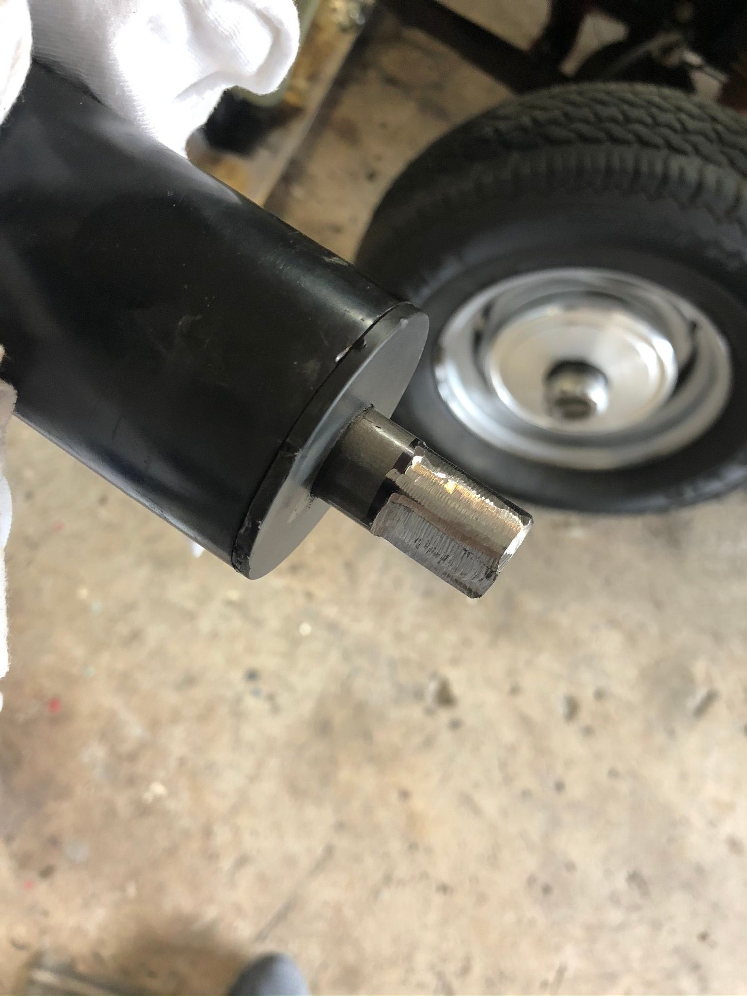

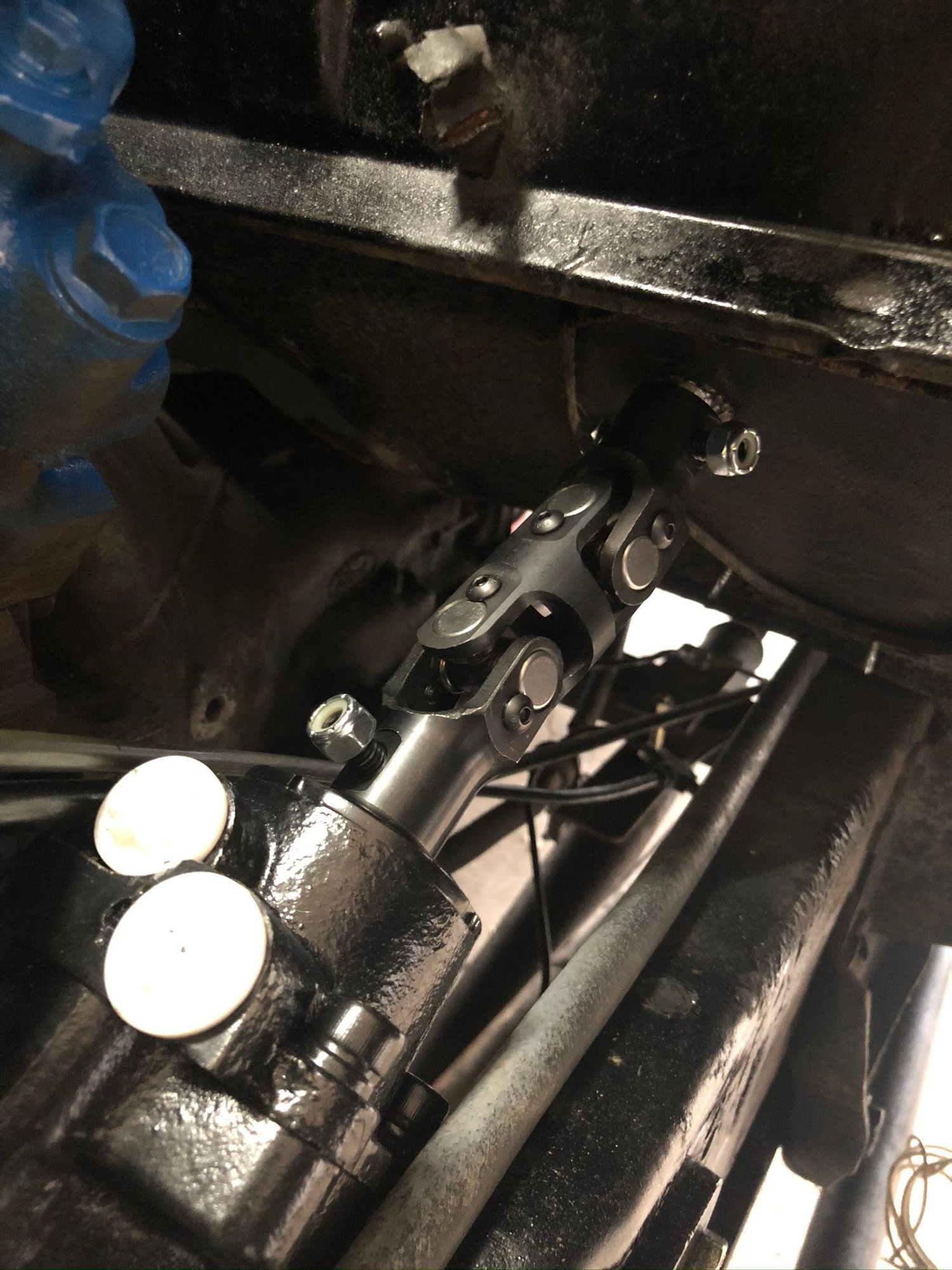

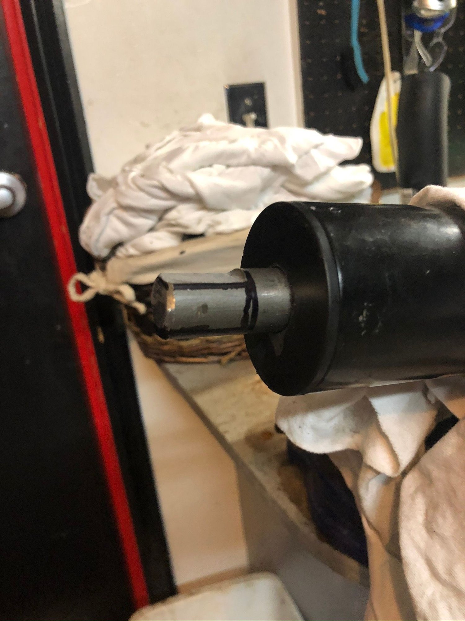

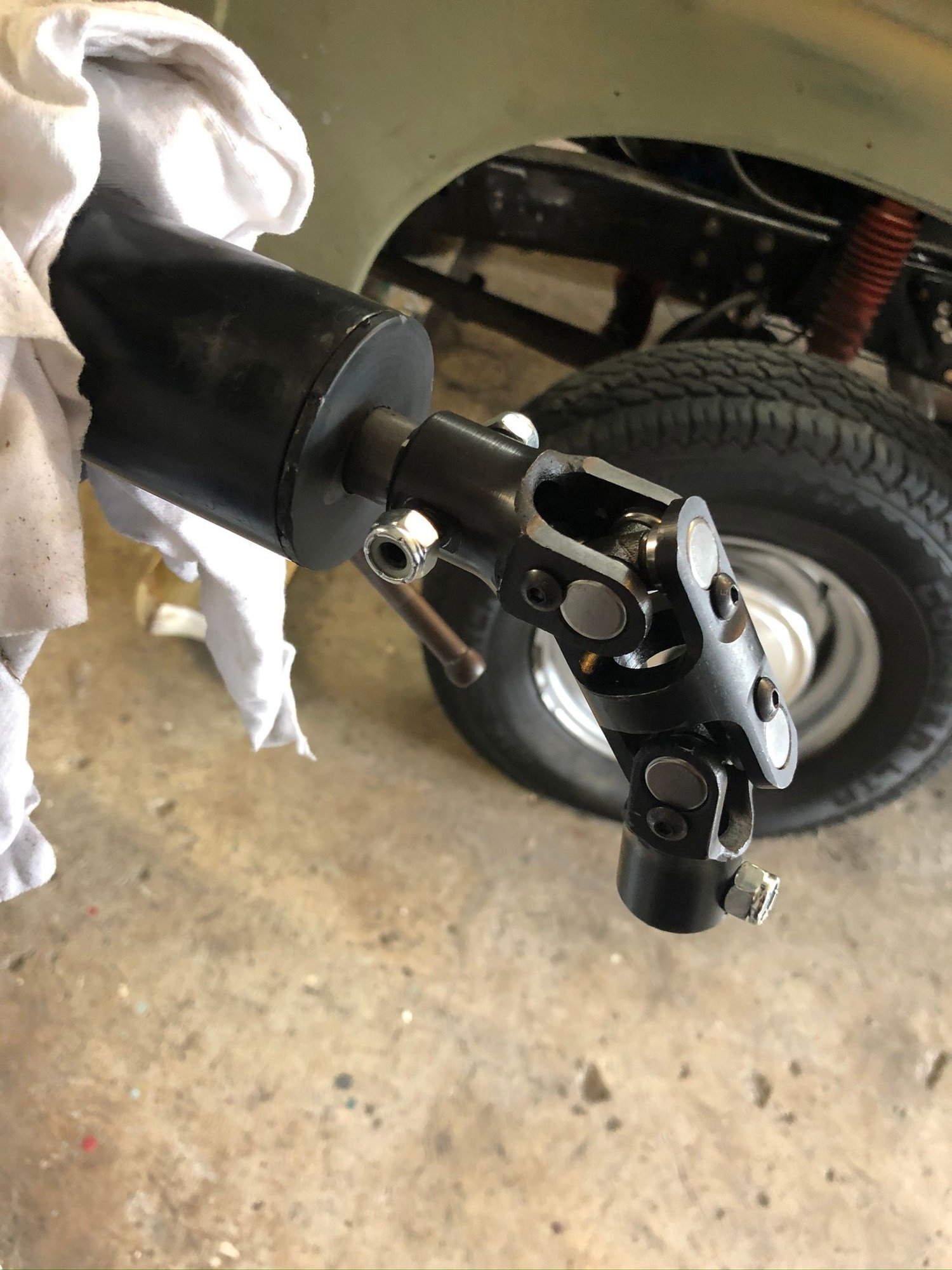

Well, I wanted to update everyone on what ended up working... I took the shaft, and decided to bear down and do a double-D grind on the shaft after measuring for length. I received the double-u-joint and it had a 30-spline 3/4" to the steering gear, and a 3/4" double D on the other end. I just got it in, and I'm pretty jacked to show it to you - this thing works, and doesn't bind at all! Anyways - this is the first time I've ever done something like this...still need to pipe in the P/S pump and bleed it...
