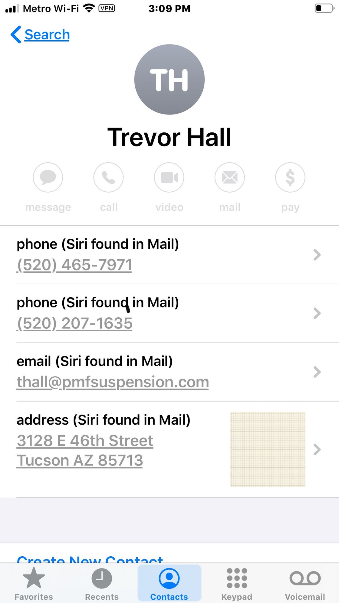

So ……. the question is what is the Part # for the Bilstein that is being used in the PMF dual stabilizer kit.
If you have 5100's on the corners it would be nice to use the 5100's on the Kelderman (which is not offered from Kelderman). But with the part # you could order the Kelderman kit and order the 5100's elsewhere.
Anyway...….. have searched and read these threads for hours and have not seen a part # for Bilstein 5100 used in the PMF kit. Anyone??

Trevor can andwer that question.

For anyone interested:
I called the PMF/Trever # above. I was told the Bilstein dual damper is 5100 794.
Doing a little searching on Bilstein.com I found a B8 5100 #33-170794
compressed = 14.72"
extended = 23.64"
makes the midpoint = 19.18"
Hope this helps someone.
