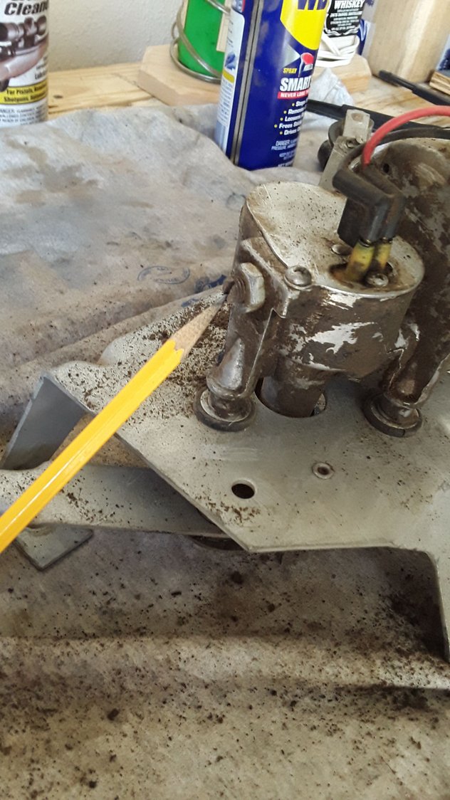

wiper motor
has any one done this/or is this an adjustment for the wiper transmission - the screw and lock nut
hard to belive this is an original part but who knows - thanx in advance

That's the armature shaft end play set screw and locking nut. Adjustment procedure below.

very good thanx for procedure pic! and its kinda amazing that parts like these last that long makes me think my odometer reading is correct about 74k
thanx again for replies
