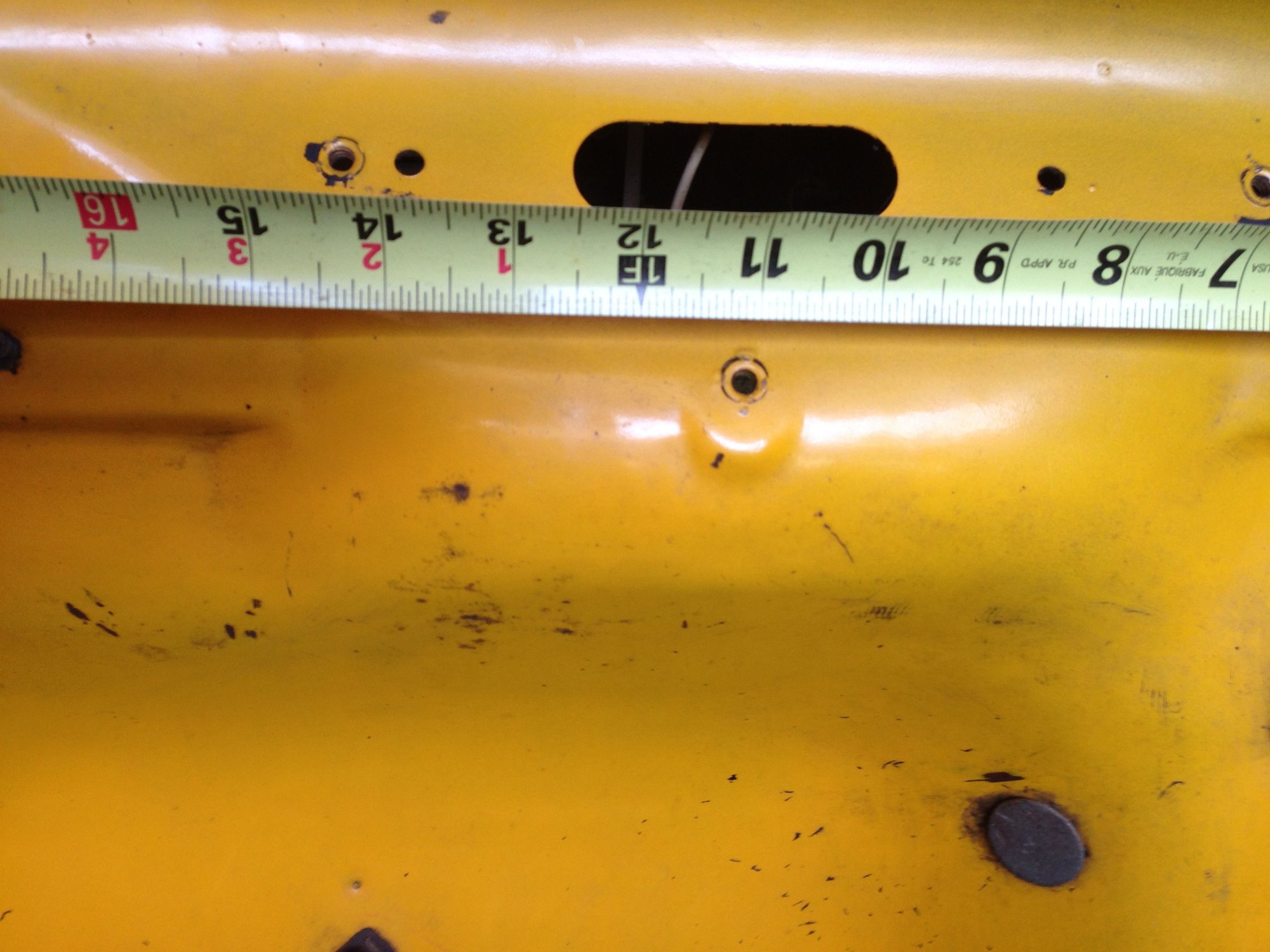

My 56 f100 has had the firewall replaced and there are no holes to mount the windshield wiper motor. Does anyone have a diagram showing exactly where these holes are located so that I can mount the wiper motor. Thanks!

Got the new motor to go inside cab, just need a hole pattern to drill holes for attachment. Hopefully someone can provide them or i suppose i will go on a search for a 56 truck to measure. thanks

Here's some pics. Hope they help.

Thank you very much for your help with my problem. The pictures should get me all the info I need to get the wiper motor installed to Fords original bolt layout.
