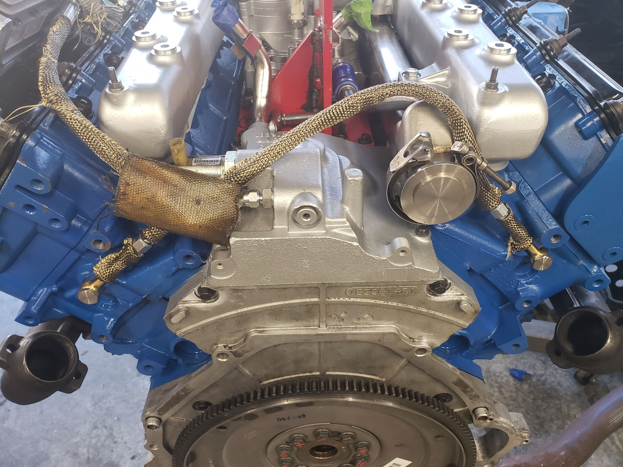

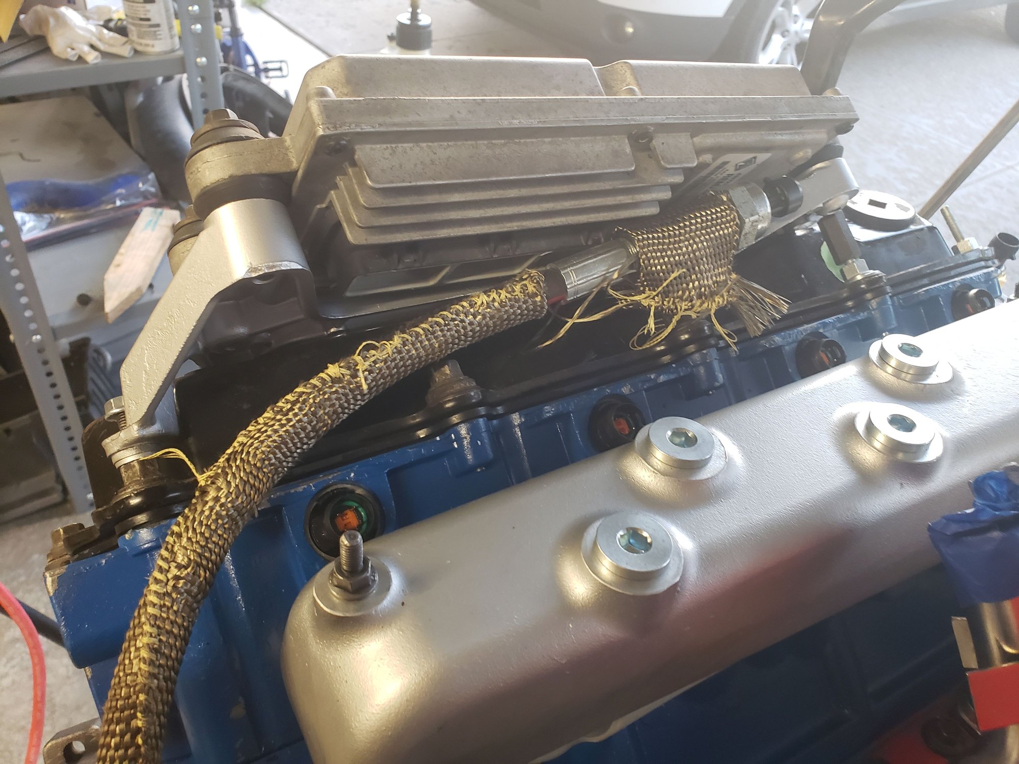

Quick Update Regarding the Tamer X Crossover Fuel Line Kit and the DFuser ICP Relocation Kit:
This is the set up I finally settled on. I used fiberglass wrap and sewed it up a protective wrap as I am a bit concerned with the heat. I also sewed up a fiber glass wrap I plan on using to secure the ICP to the main wire harness.

More pics please!
Crazy on the hand stitching. Man-o-man...
