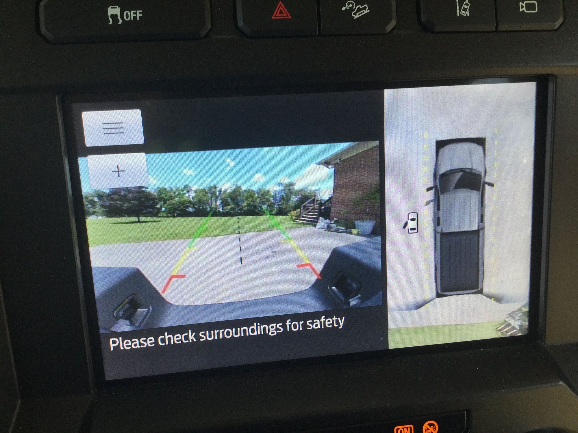

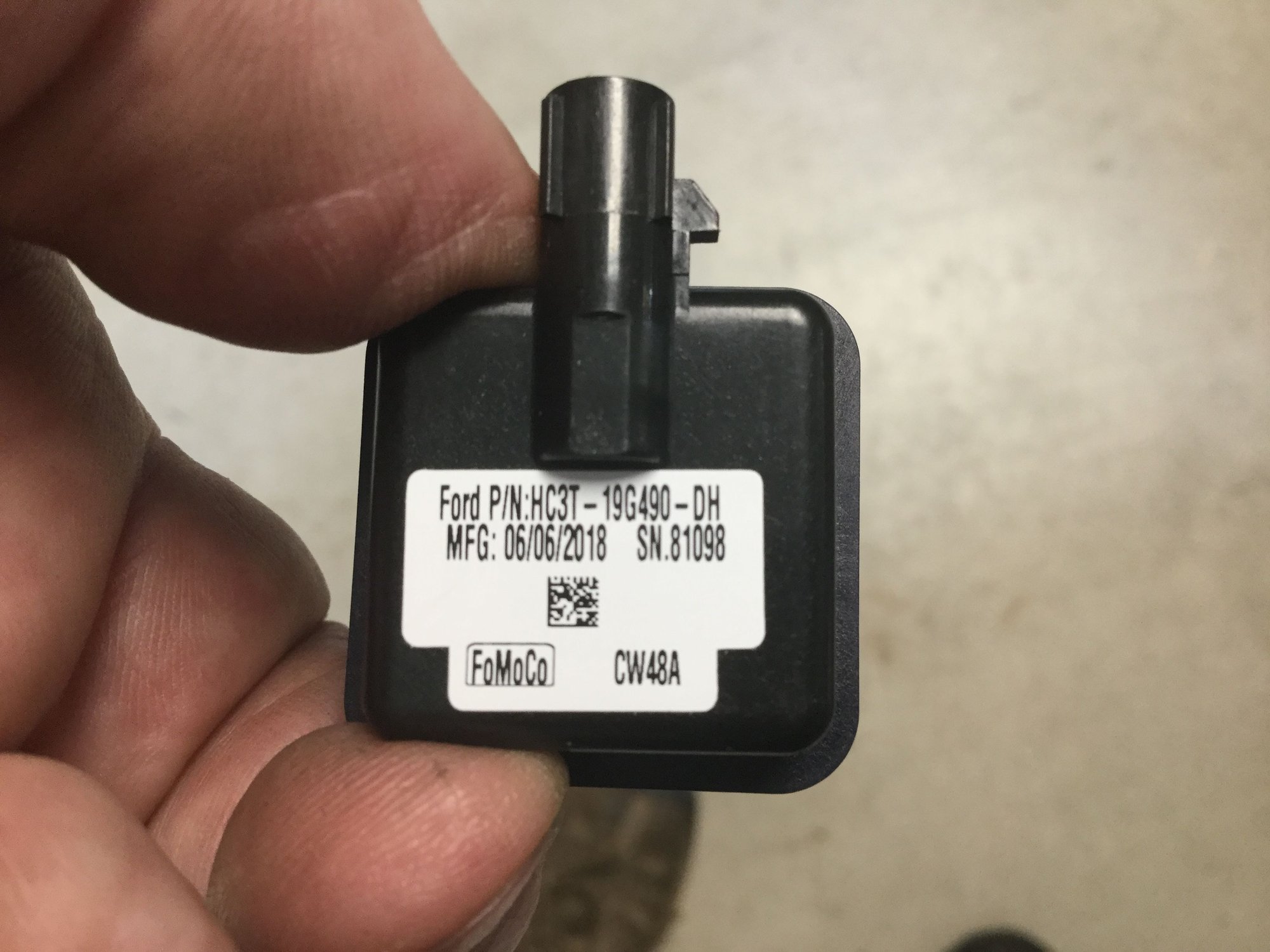

Like a lot of you, I’ve removed my tailgate for hauling a camper. I did get the additional camera for the camper, and it works well when the camper is on. But when the camper is off, I miss having the 360 camera, especially when hitching a trailer. I didn’t want to pull the original camera from the tailgate, so I looked at aftermarket solutions, but $400+ seemed pretty pricey.
After some searching, I found the part number for the original camera and the type of connector connecting it. After that, I turned to eBay. Found a new in box camera for $160 and brown Fakra connectors for RG58 coax for $15. For an enclosure, there was already a piece of plastic trim on the rear of the truck that seem to almost be made for it, so I used it. Drilled a hole and mounted the camera with hot glue for now.
It’s best to mount the camera as high as possible, so for now mine is mounted to the camper platform. If you don’t have a platform, it can be mounted just below the bed. It works well. The only issue is, the image with the 360 view is a little wonky where the rear image is stitched to the sides due the camera being lower and part of the bumper is visible. Otherwise, it’s good. Here’s a couple of pics.

I have one on the camper that plugs into the 12 pin connector too. It’s nice to be able to switch back and forth between cameras. I have a toolbox on the truck, so I can’t see into the bed or the bottom of the camper when I’m loading it. But, I have a center line drawn on the bottom edge of the camper and use the 360 camera to align it when loading. Once it’s loaded, I switch over to the camera on the camper.
