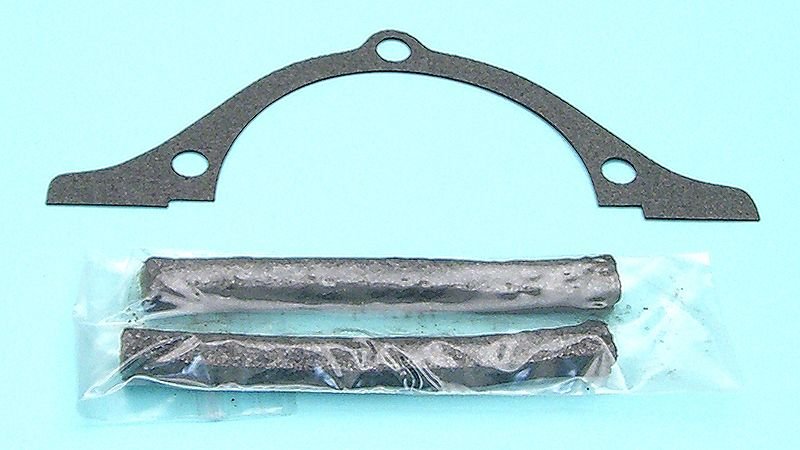

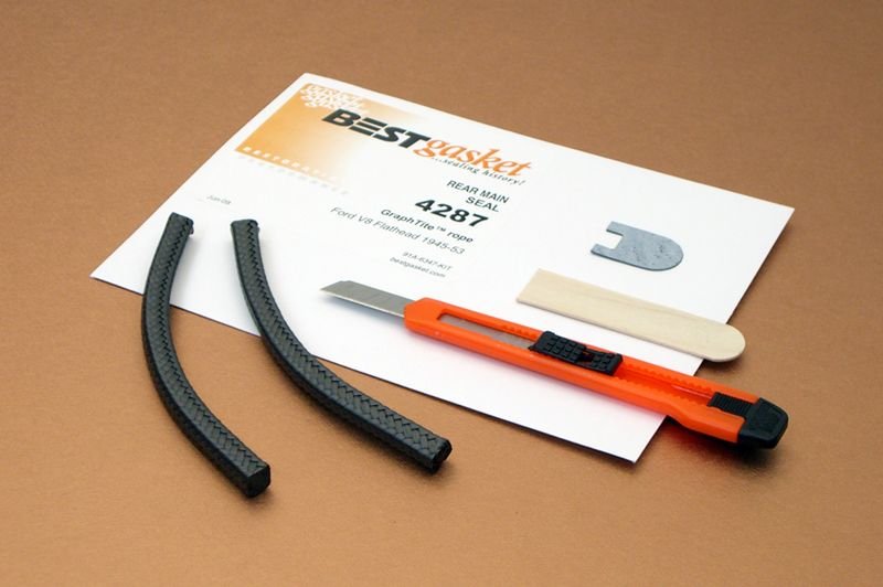

Hi all,
Having spent an afternoon digging through old threads (https://www.ford-trucks.com/forums/1...d-packing.html) and searching the web for vendors, I still am confused about the front and rear rope seals on the 226 flathead.
The manual shows three different part #'s for the seals: 6700 (rear upper), 6707 (rear lower), 6701 (rear upper and lower). I've only found one vendor who seems to make these (https://bestgasket.com/rear-main-seals/). They show a kit specifically for the 226 (#7091), which is different than the one for the 239 v8 (#4287). After digging around, I found the front gasket kit, which includes the timing cover gasket too (#GS11045).
So does anyone know if these seals are more-or-less interchangeable??? Basically, are there 3 original part numbers because the original seals were different lengths? Any are the v8 rope seals actually different than the flat6???
Thanks and happy 4th!
badger_hound
Best Gasket kit 7091 - 226 flat 6
Best Gasket kit 4287 - 239 v8
Best Gasket kit - 226 flat 6 front seal/timing cover

Ok, this is what I found out after calling Best Gasket and Fel Pro:
The Best Gasket rear kit and front kit (timing chain cover) uses the same rope seal (part#2244). According to their tech support this is definitely a different thickness than the rope seal used for the 239 v8! The 226 rear seal kit (#7091) can be special ordered through EGGE (1-866-534-3443), and costs $20.26. These rope seals are also included in the Best Gasket 226 rebuild kit (RS528C), timing cover kit (GS11045), and oil pan kit (29008), which are available through assorted online vendors.
Fel Pro does not currently make a rope seal gasket for the 226, according to their tech support, although they make rope seals for other engines.
So now I'm pricing gasket kits as I need an oil pan gasket, front and rear rope seals, timing chain cover gasket, and head gasket. The Best Gasket engine kit is about ~$160-180 online and includes the rope seals, but also a bunch of extra gaskets I don't need or that I can easily make myself. So I'll probably just get the Fel pro engine kit (~$70 at rockauto.com), which doesn't include the rope seals, and then order 2 of the rear seal kits from EGGE.
EDIT - actually, I found a better deal on the Best Gasket 226 kit on ebay and ordered that for $140 (https://www.ebay.com/itm/Ford-6-cyl-...1/253576190817). This vendor also has the same kit for about the same price ~$150 (https://vintagegasket.com/shop/engin...ng-set-rs528c/
