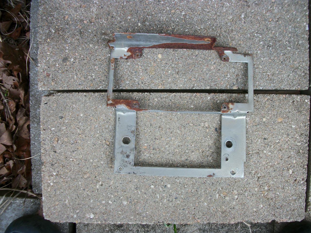

Is you do not want a complete dash to swap, I can get you the patch panels you need, custome size cut from a parts truck dash. And you need this part too. Welcome to FTE.
