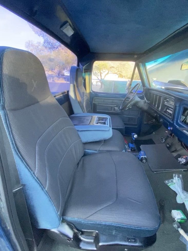

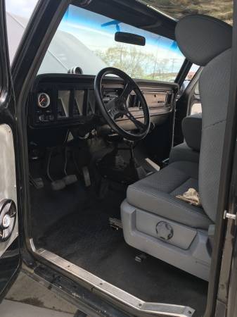

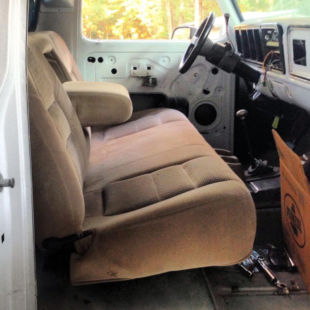

Lots of options.
01 SD rear seat. I am doing this set up right now. Used some square tubing to make 1.5 riser rails.
95 Eddie Bauer F150
2005 in a SC
2011 in a SC
Another 95 Eddie Bauer
