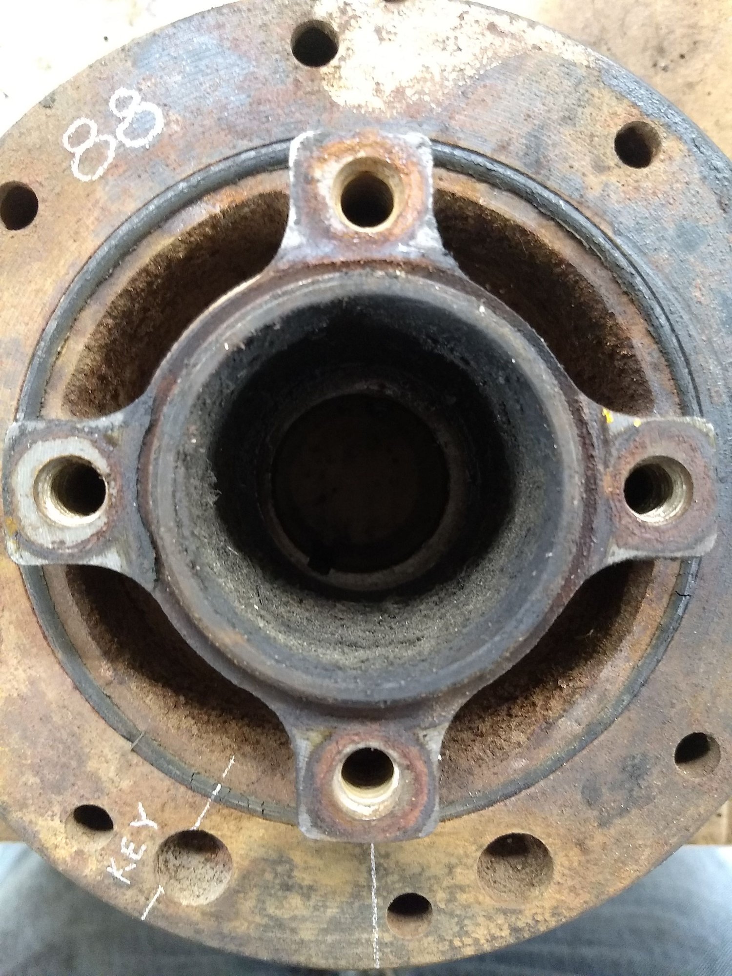

Please help me understand what I need to know about the harmonic balancer for my 5.0L. Top is balancer off my 1986 5.0L. The keyway appears to be at 30° BTDC and 0° seems to line up about perfectly with the pully bolt holes.
The photo below is the balancer off of a 1988 5.0L. It looks as if it is different. It looks like it has drifted about 1.5° from where the'86 is.
Questions, do these drift? Are they a wear item? Should my low HP engine build get a new one?

Both have identical part numbers, E4TE-A3A.

I wouldn't worry about it, and simply reuse it. The new Chinese ones probably are much worse for accuracy.

The crank key way lines up with the timing marks on the timing set. The position of TDC or "0" will align with the timing pointer, so the two should not be aligned with each other.
