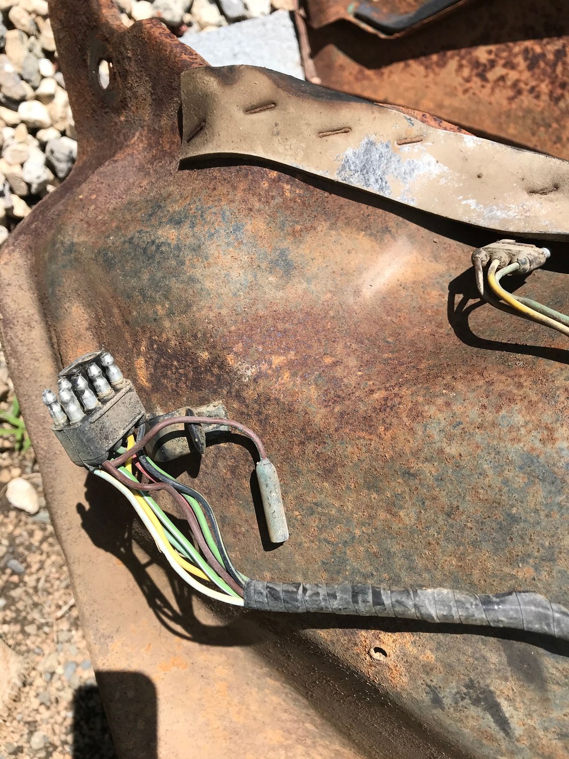

I swapped my steering column for the one from the donor custom cab. Mine was missing the wire coming out the bottm of column. Is that a ground? I have a bundle of wires going to the taillights with an extra white wire with bullet connector. Also the steering column wires are not same color. 1959 ford manual not very clear to me. Solved steering column wire issue. Found turn signal switch mounts broken. Moved switch assy and wires from old column over. Hoped to use what was left of custom cab horn button but it doesn't work on my standard steering wheel.

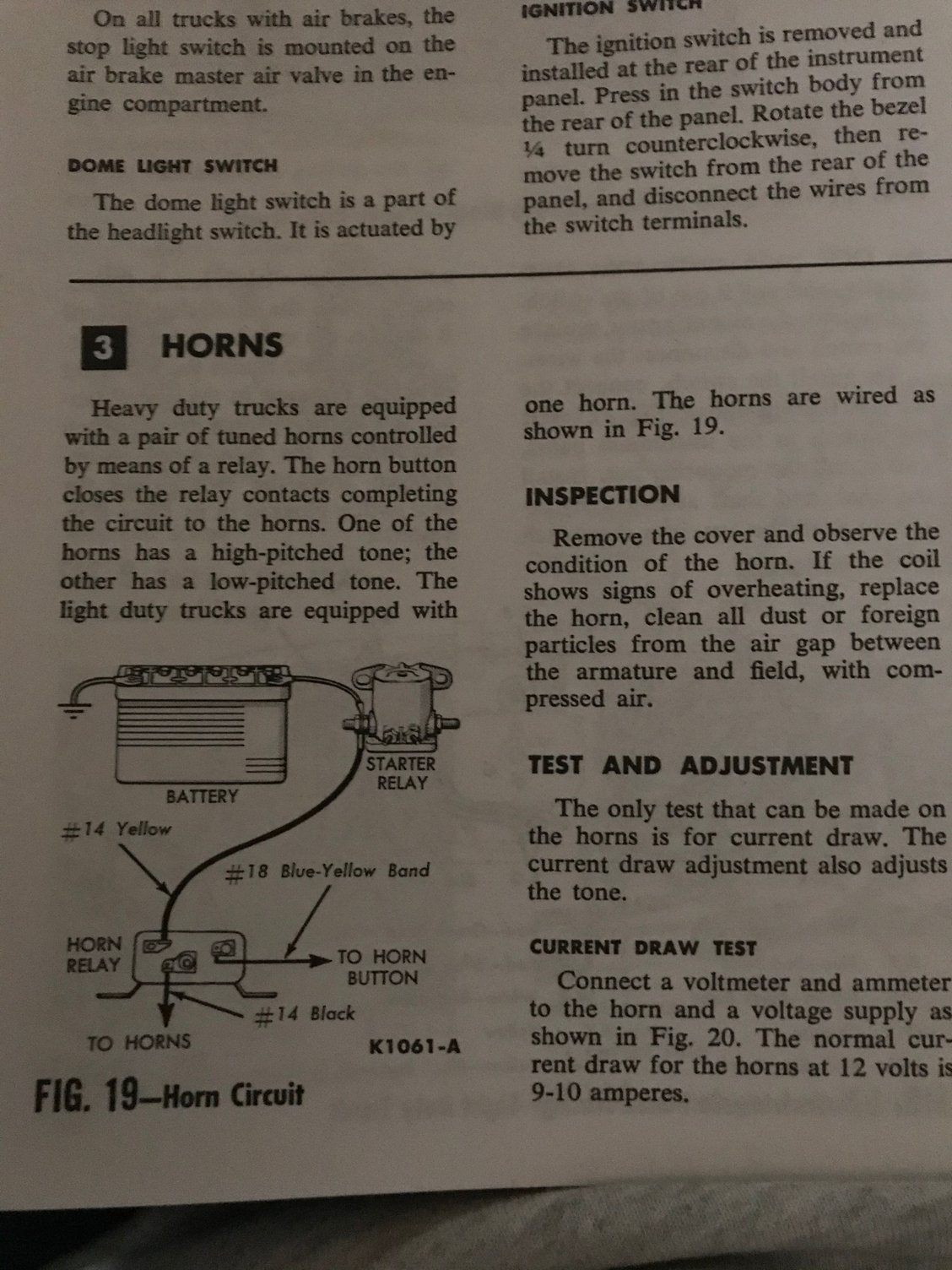

Here is the horn relay. The smaller middle wire is what you want. It looks like it pops out the other end by the body harness plug. My horn wire is missing the bullet so I don’t know if it’s male or female without checking further and I can’t tell the color until I clean it it all up. Hope that helps

Ok, found it. It did connect to horn relay. On mine it is a blue wire although the part not taped was faded to white. Previous owner taped up that wire with the taillight wires which threw me. With tape removed it makes sense. I assume it is the ground for horn relay?

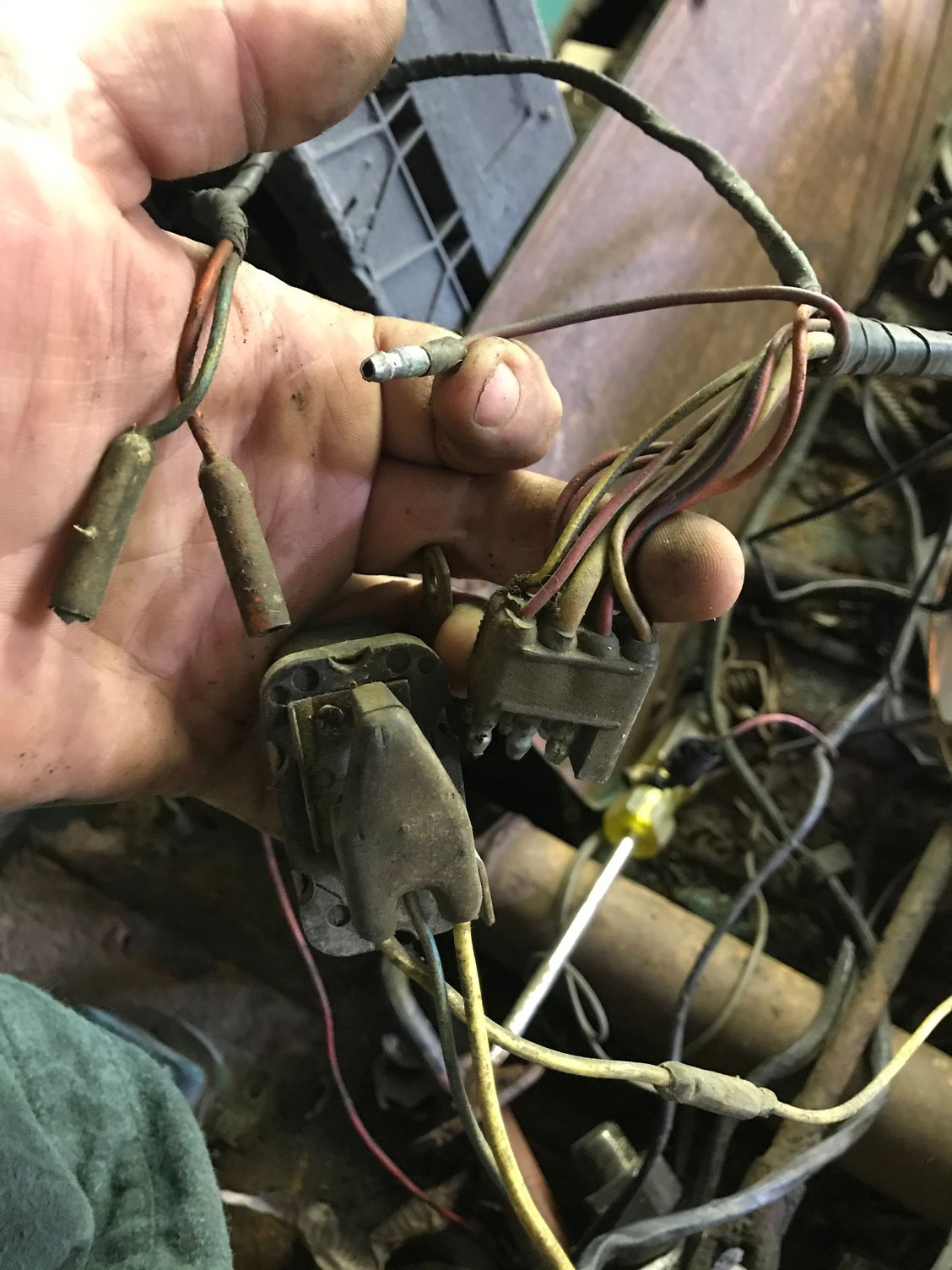

Horn relay bad. Found contact in bottom of relay. Hoped I could clean the contacts and be good.
