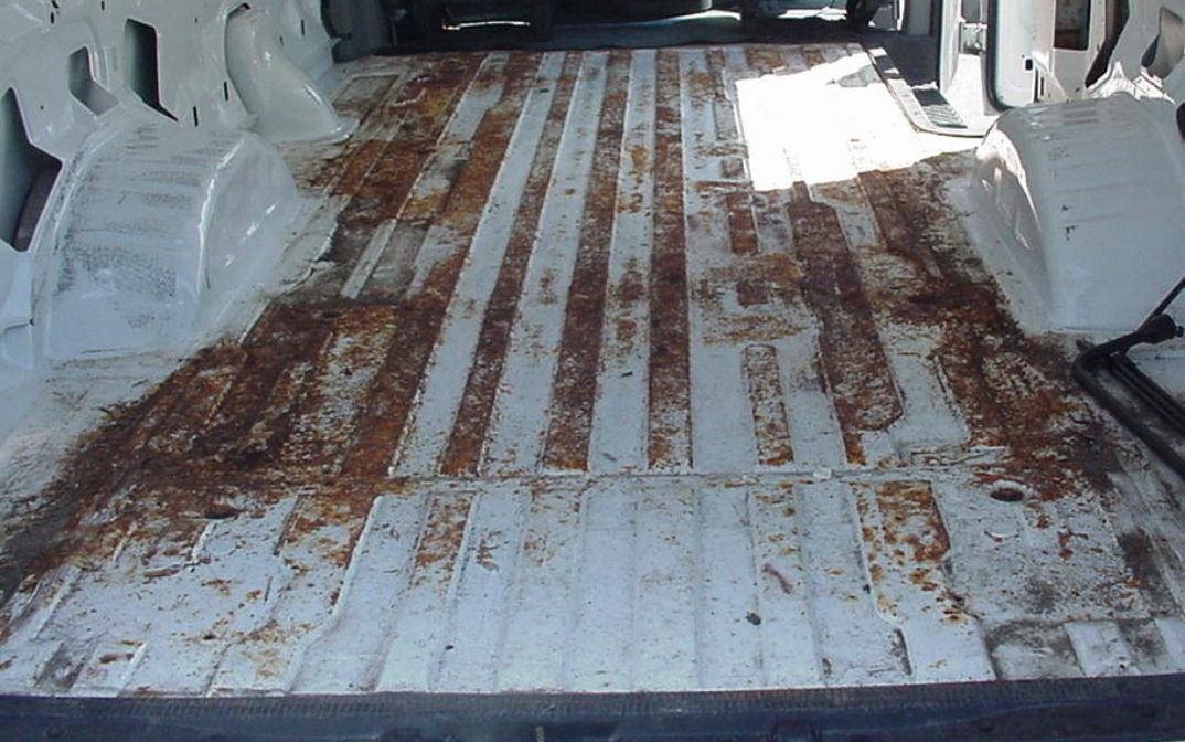

As a word of caution you DO NOT want any sort of carpet or similar material that'll absorb moisture---the factory mats with the spun padding are the best example of what type floor covering you want to avoid. The vans sweat, the padding absorbs the moisture and never ever evaporates back out. Exterior surfaces you can see may look dry but the padding is soaked. That trapped moisture lays against the steel floor and over time causes rust which goes undetected, sometimes almost forever.
I place my plywood so it spans the floor ribs leaving air spaces. Any moisture finding its way into those spaces is free to evaporate out as the van becomes warmer while driving.
The front seems more quiet because there are more soft surfaces to absorb road noise, the cabin being behind the front suspension so it doesn't transmit road noises inside. Do keep in mind the same cautions about factory floor covering with the spun padding applies to the front as much as it does the rear---if keeping a van for the longer term its a good idea to remove the front seats and floor covering to check the floor condition. Sadly that can be downright scary
Two photos showing more of the surface rust that can form unnoticed:
Please none of the rust showing had perforated the floor---for the most part it was just surface rust. It was properly treated with POR-15.
