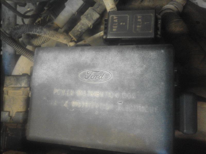

Thanks guys, but that's all info I have. The pic I'm posting is of a double relay box, between the power dist box and the firewall. This does not show up on the diagram on the locator page nor in the OM on the fuse relay location pages. I need to access the wires on the bottom of the pwr dist box so looking for the trouble shooting/diagnostic pages alluded to in the electrical manual, exact pages id'd earlier. Thanks
What are the relays for in the plastic box next to the power dist box on the left inner fender?

Is the above photo of your truck?
If so the relays inside should be the "trailer back up lamps relay" and "trailer battery charge relay".

Yup, that's a pic of my truck. 2 relays there, ones for the back up trailer lights and the other "directs current to charge trailer battery" Is this for a remote battery like you'd find in a camper, or a battery that some folks have mounted on their trailer for a winch? If so then a guy wouldn't need a battery isolater, diode type arrangement to keep the batteries separate but allow for charging? I can find no Ford information on this stuff. Thanks. Thats the reason for this whole post, is wiring the truck for my pick up,pop up camper, I use for ag swap meets, steam threshing shows etc. Thanks guys................... Larry
