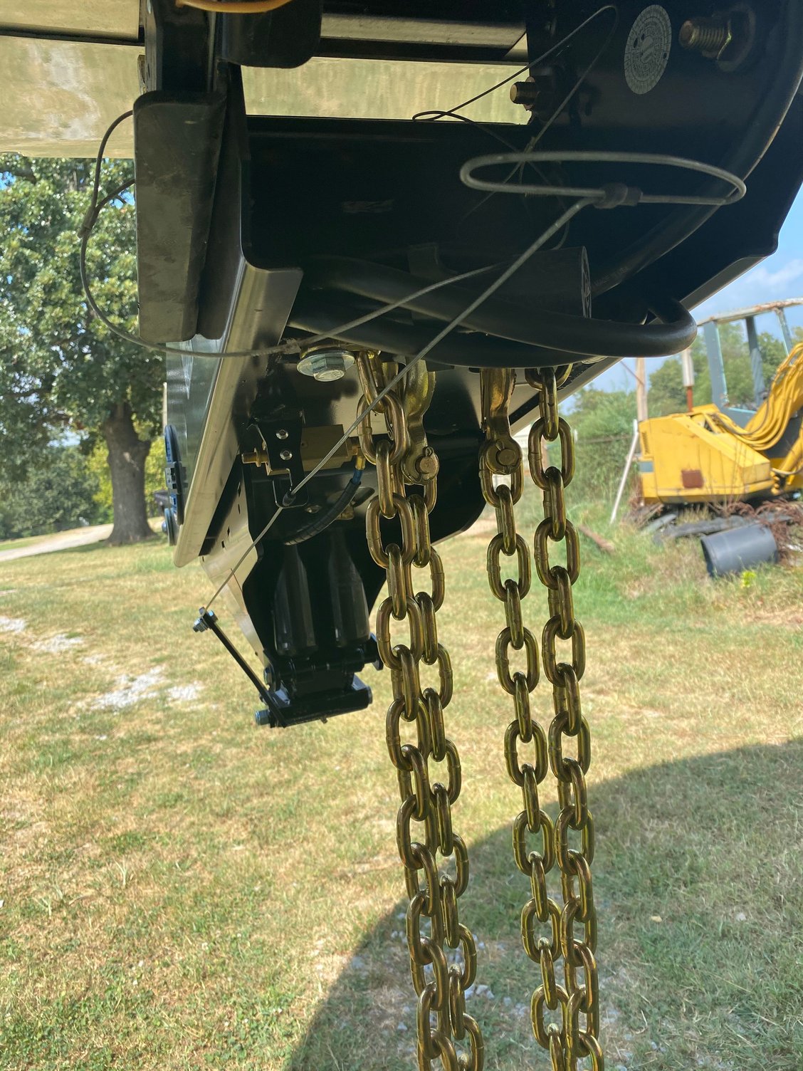

I went to lengthen my cable on the Goosebox and used a piece of high-tensile fence wire to get some ideas. I decided I liked it and replaced my cable with it. It is stiff enough that it stays where it is easy to grasp. If it fails, I have the cable to put back on.
That is a good solution too. I used mine for the first time on Sunday and it was rather pleasant not to have the lean all the way in there to grab it.
