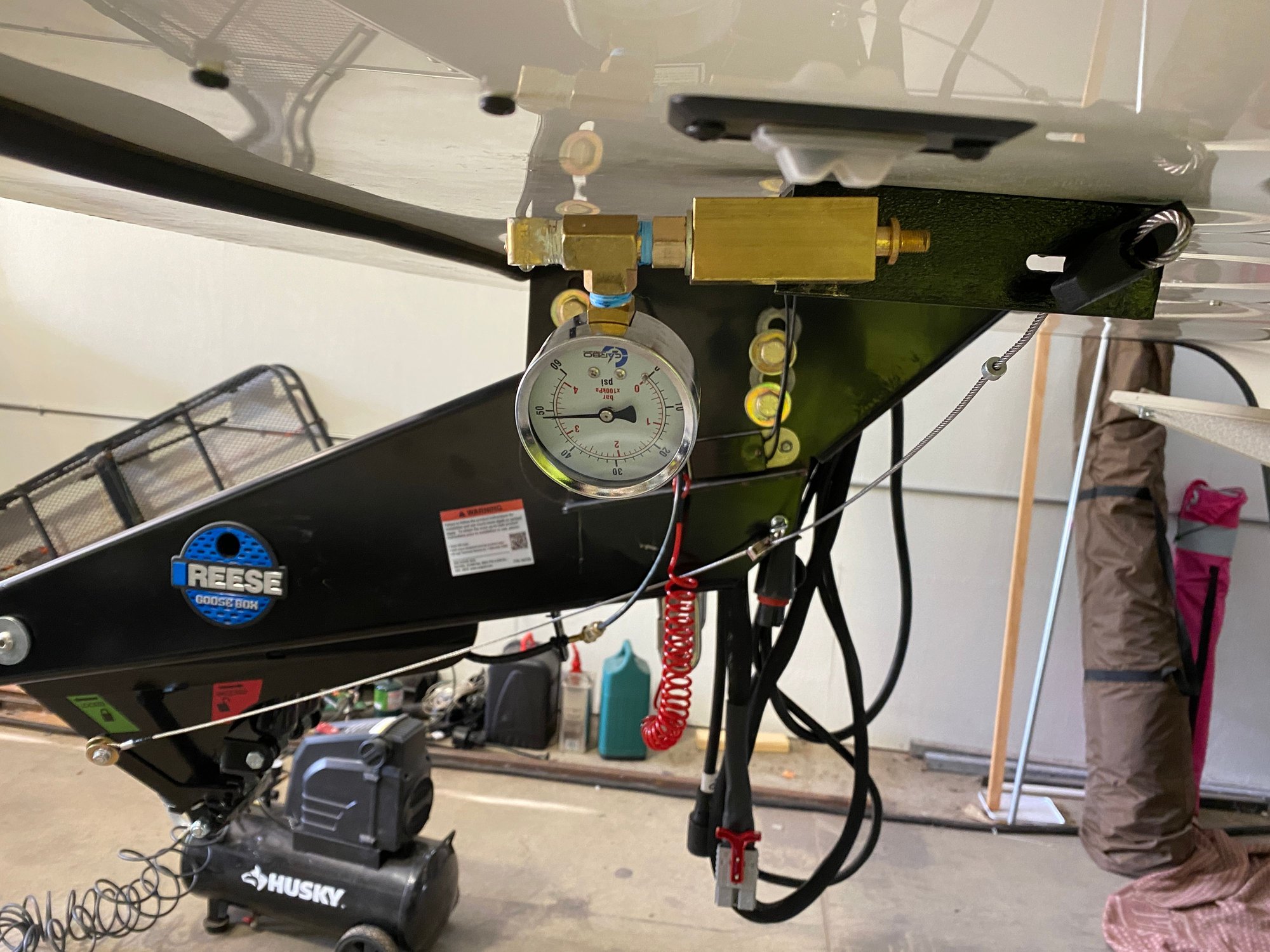

Can you elaborate on the pressure gauge, please? I just bought a Goosebox (20K), but haven't installed it yet (trailer is in the shop). I think the gauge sounds like a great idea. Details on what gauge and how you mounted it would be much appreciated!
Regards,
John
I installed a pressure gauge in mine as well. I also extended the release cable and moved it closer to the side of the rig so it was easier to reach to unhook. Only trick was the air fittings are not NPT, they are BSPP. I found adapters on Amazon, and used a Tee to connect the pressure gauge. I will try to get a photo tomorrow.

I’ll try to get some pictures today. I got some stainless braided cable and put a pulley where the handle was mounted originally. Then took a piece of angle and drilled some holes in it, ran the cable through and put the original handle on the end. I mounted the angle on the underside of the fifth wheel overhang. It makes it much easier to use. The cable is only in use when unhooking, so no safety issue going down the road.

Thanks! Sorry I did not get over to the rig today, I definitely will be other there tomorrow. It was pretty easy, I cut the factory cable and then there is a set screw in the stopper that holds it open you loosen and pull off. Then I got a small pully and fed a new cable through and reinstalled the stopper and handle. Makes it much easier to use.

I got a brass 1/4x1/4x1/4 NPT t-fitting (all female), a brass 1/4x1/4 NPT hose fitting (both male), and pressure gauge (Zenport DPG60) on Amazon, along with some Loctite 565 thread sealant. Putting it together is pretty easy. It’s really handy to have. Just a quick glance and you know, no dragging out a pressure gauge each time.
