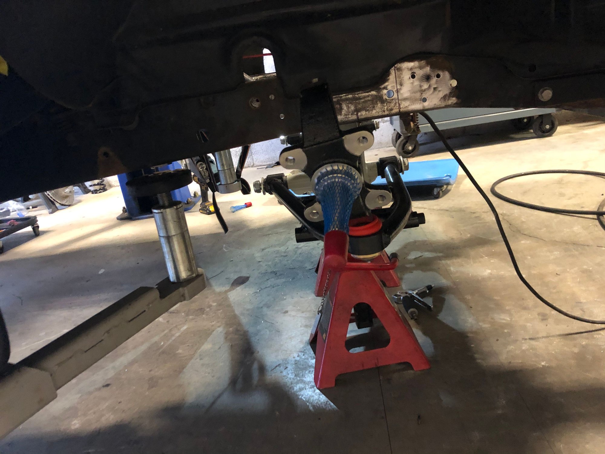

Ok, so we had a little bump on the road.... mustang 2 front end came with the wrong rotors. It took then a couple of weeks to fix the issue so we couldn’t quite work on the front end since we wanted to let the truck sit on the tires in order to measure correctly with the new engine and tranny in place to place everything where we really want it.

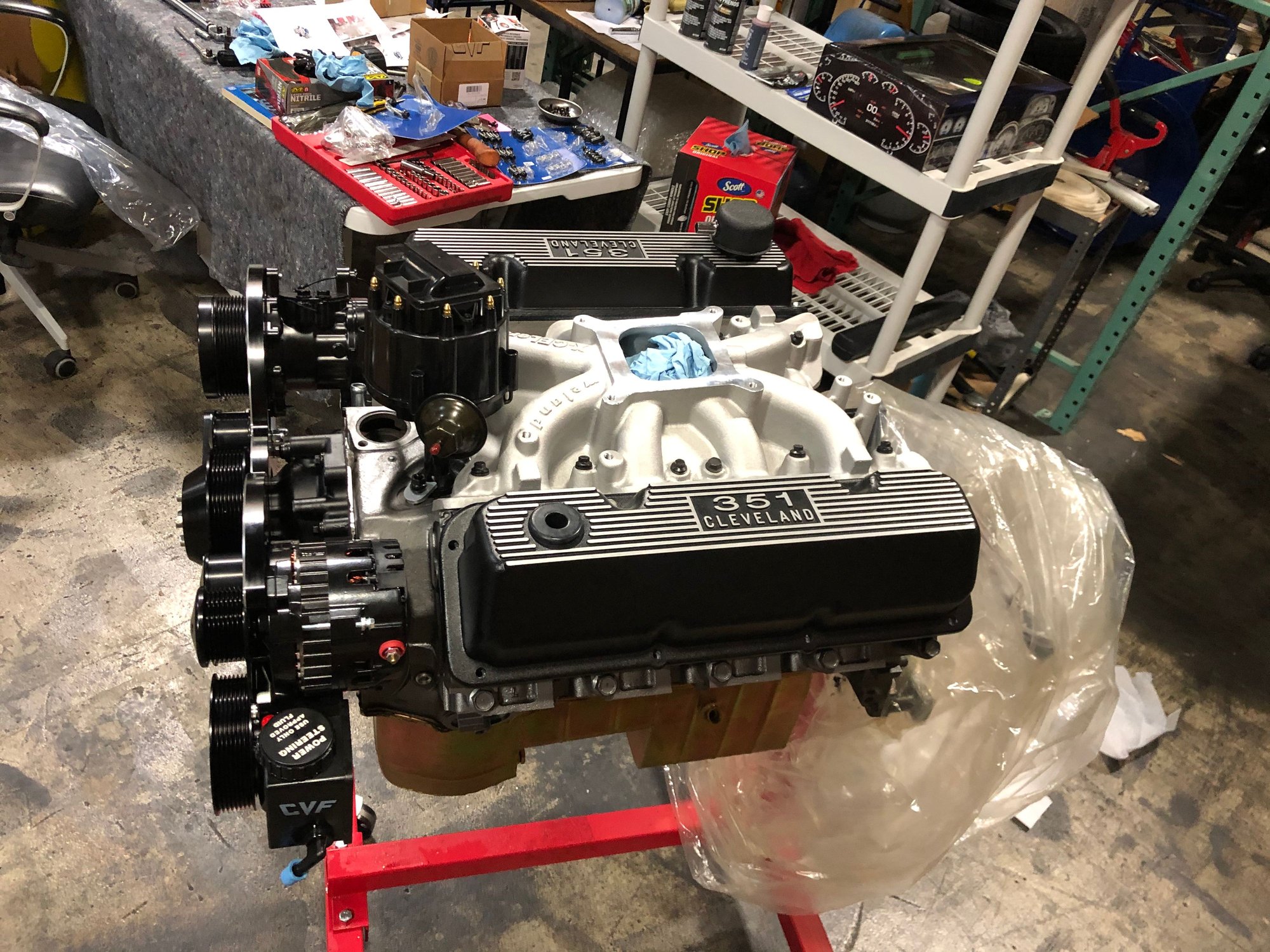

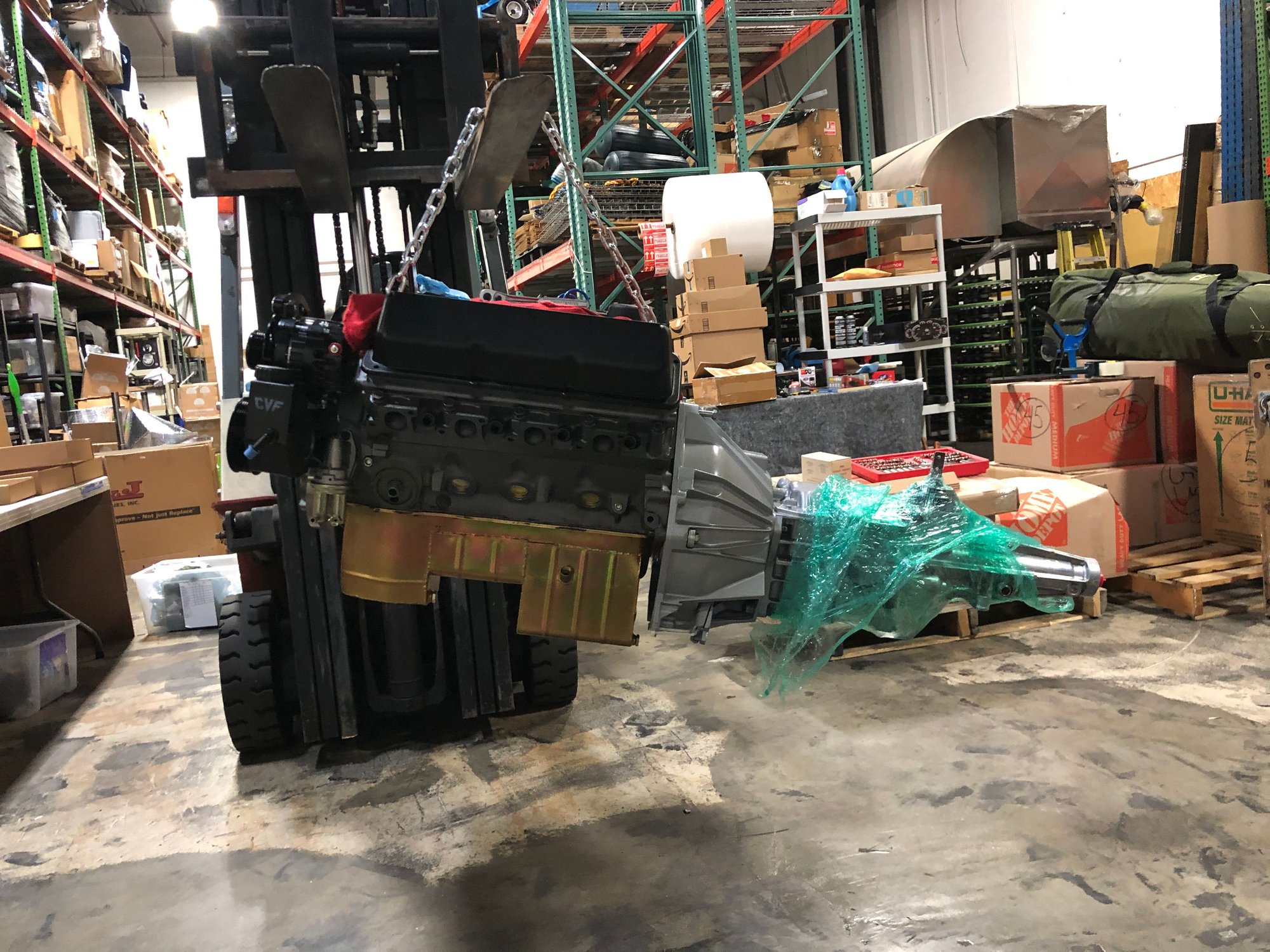

in the mean time we finished the engine and dry fitted the transmition. Once we figured everything went together perfectly we finished up details and did the break in and dyno tuned the 351C.

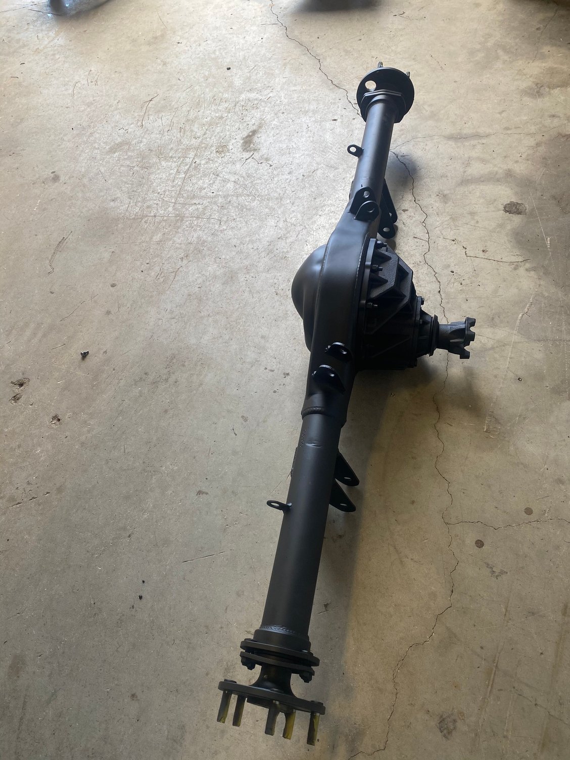

Rear end and shocks in place
Another angle
Rear end painted and ready to go in place

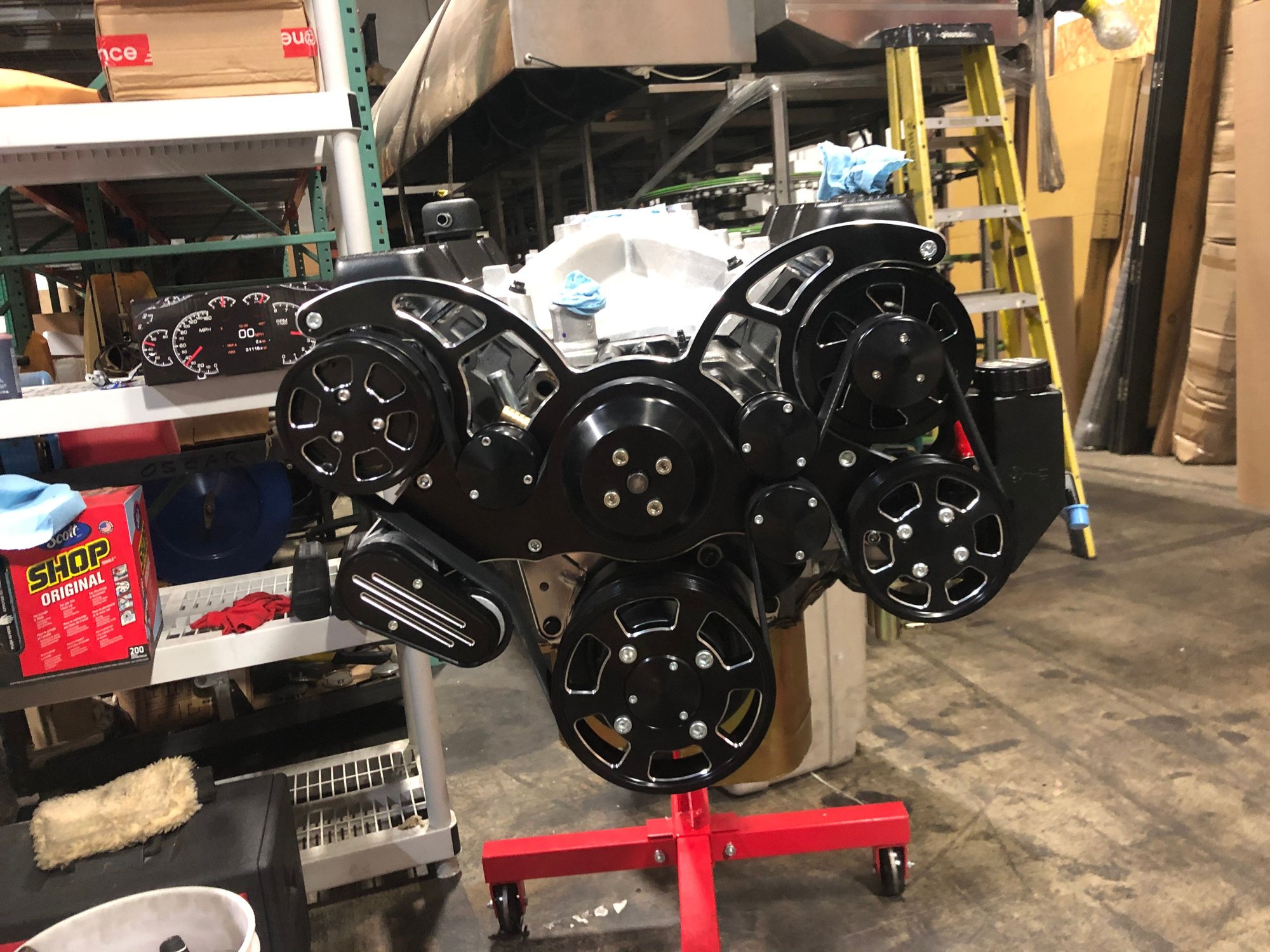

Engine coming together but we realized balancer was wrong, they sent us a balancer for a 351W
Engine and transmission dry fitted
Finally got the right balancer and was able to finish serpentine kit
Engine and transmission together

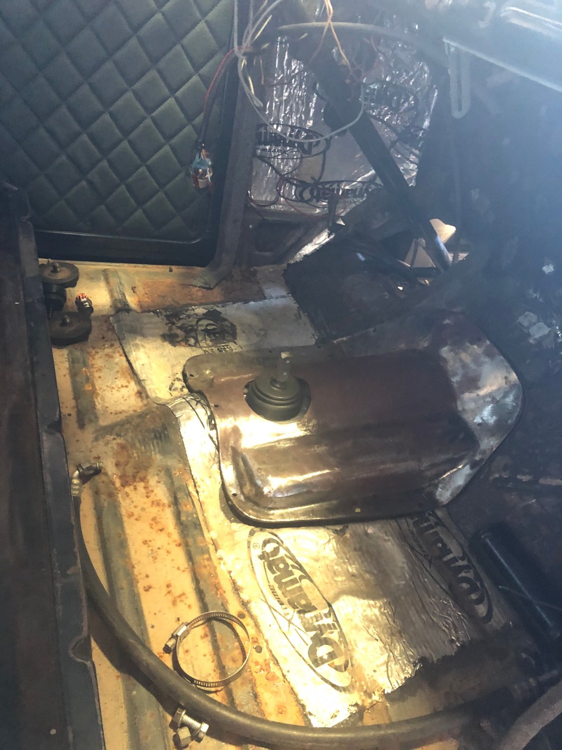

It is working for me! I would say that the stock drivers seat won't be working for you; will maybe in a straight line.
Old Dec 21, 2020 | 01:55 AM
Freitasjr83's Avatar
Freitasjr83
Joined: Jun 2020
Posts: 20
you are saying this because of the shifter location? If not please explain....
If so, it is a concern that we have! This week we will find out how bad the alignment is.
we are hoping it will just fit and we might have to fabricate a shifter with a forward angle.... at this point if it doesn't work i am not sure what i’ll do since we already have everything setup.

Ok, so engine and tranny went in. We had to relocate rack and pinion a little lower in order to clean oil pan. Made new custom motor mounts on chassis to hold engine in place and everything else went smoothly.
we then removed the engine again and started working on the engine bay firewall and taking apart the interior.
next we will fit engine back in order to figure out clutch and break pedal position and setup with break booster, master and valves. Then we will re wire the truck and start putting in back together... we are getting closer....
How much is a little on relocating the steering rack? Altering the geometry on steering components can induce bump steer and make driving not so much fun.
It was moved forward a bit everything was taken in consideration, mustang two front end is adjustable and allows for some relocation.
we were able to set the engine low in the bay to lower center of gravity.
right now truck is sitting on suspension in order for it to settle some, so we can get back to work on it.

Trany and shifter location came out nice
Trany cover with shifter location worked out just fine!

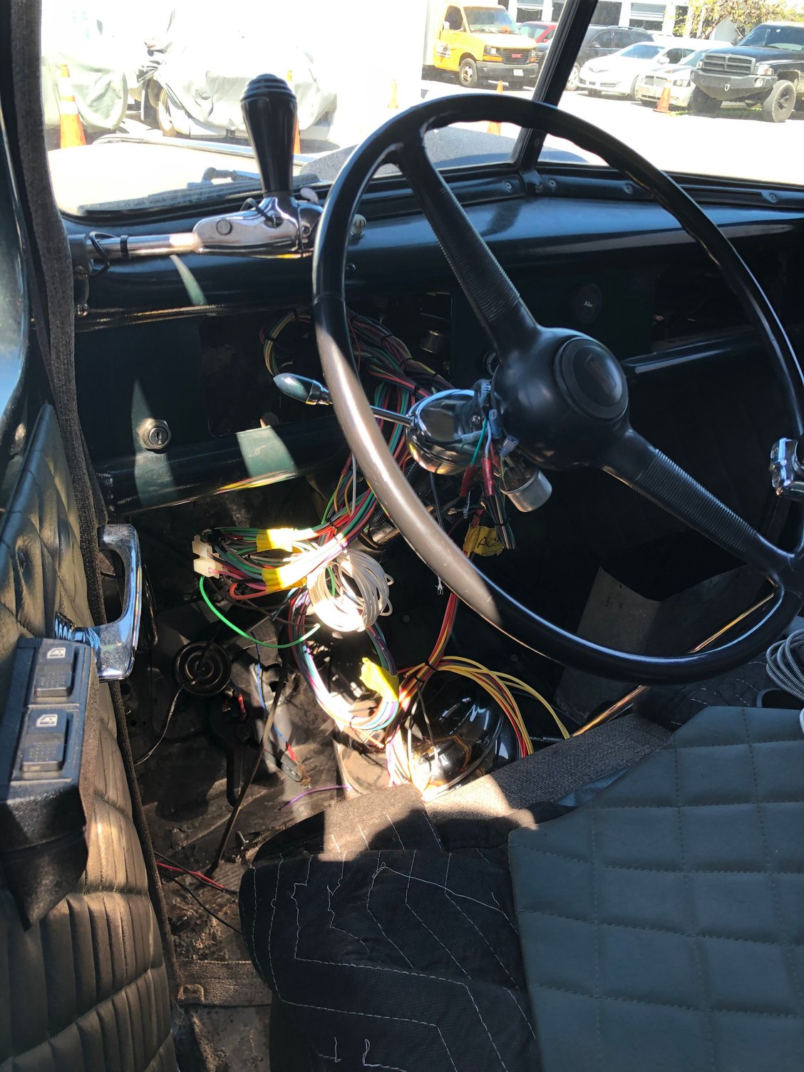

Rewiring is in the works. We will be installing a dakota digital gauge and hidden vintage air A/C system.
the plan is to fabricate a metal strip to mount under dash and put a/c controls and vents on the strip in order to preserve original dash.
Working on cab and then moving to the hood.
Cab wiring
Rear is basically all wired up. Battery will probably go under the bed wood in order to maintain the engine compartment clean.

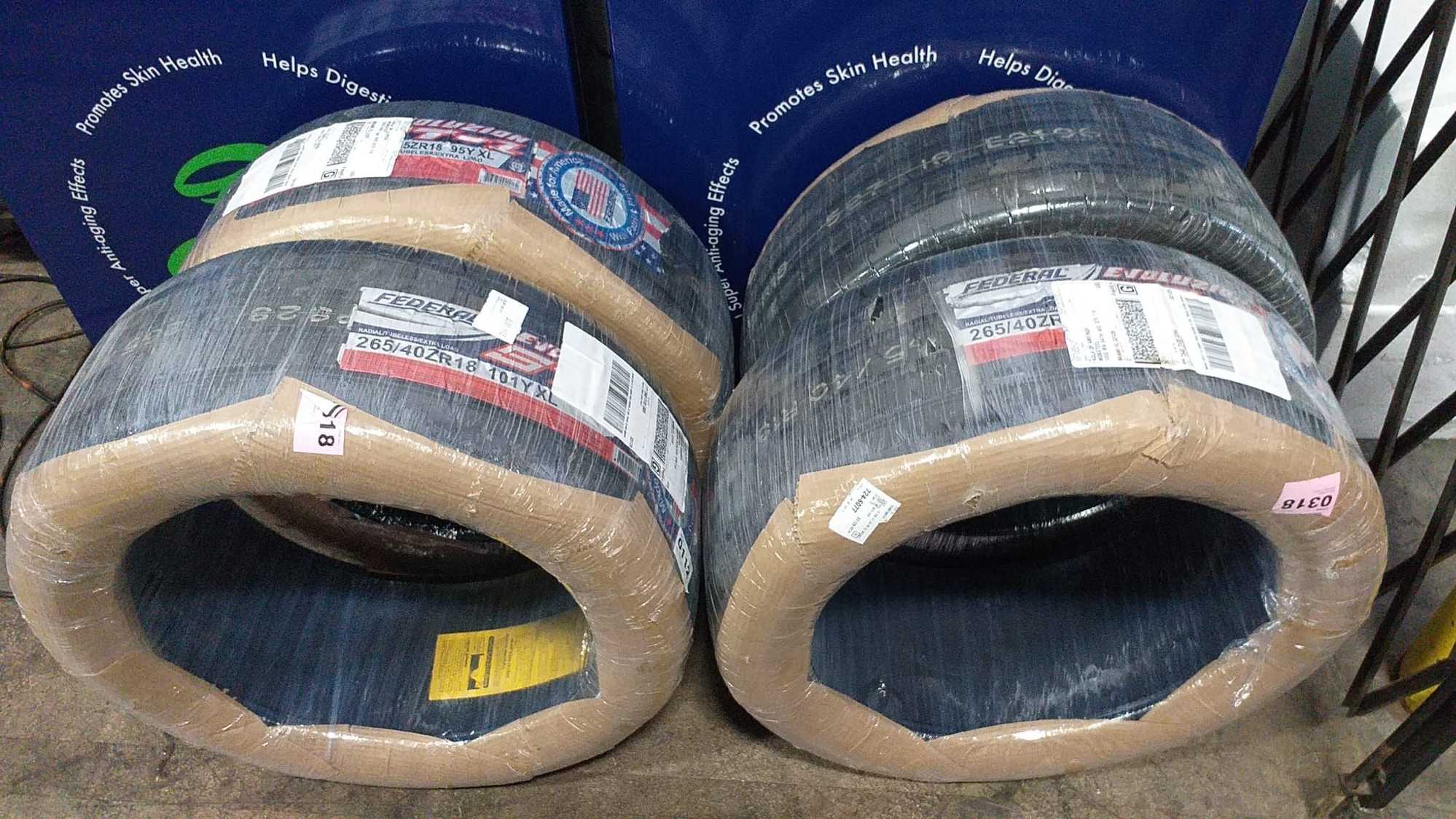

wheels and tires have arrived. Waiting for wiring to be done in order to dry fit wheels before sending it out to powder-coating.
Low profile tires with custom white stripes.
