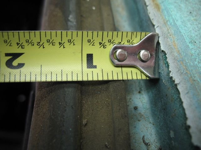

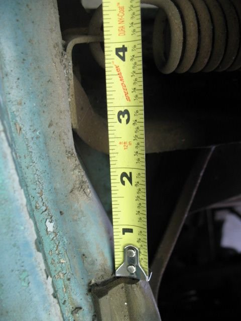

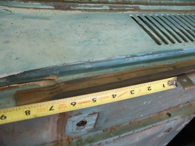

Just in case you need position/dimensions....
