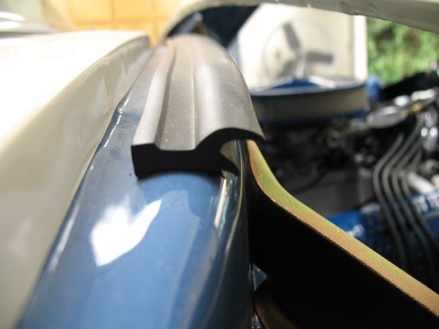

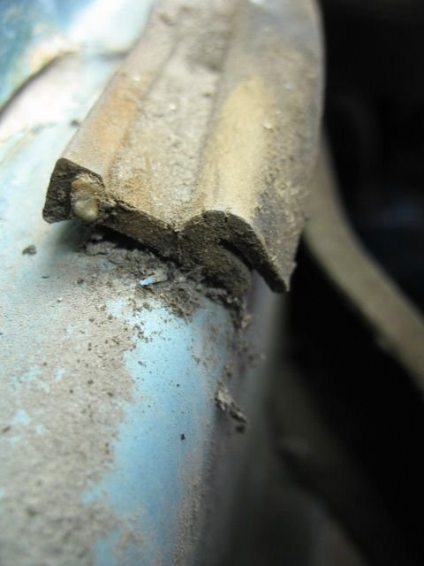

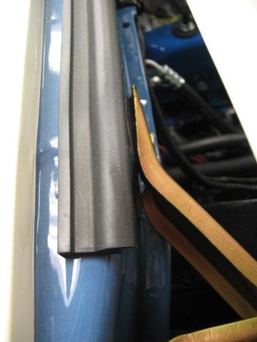

Original and Restored:

Resonateur, That is how I thought it should be but the nail holes are in the valley on mine. That rubber is about the only thing I did not take pictures of upon disassembly. I tried gluing it to the hump like yours is and it did not stay down. I used black weather strip adhesive from 3m

If you look at the photos of the original, you can see it's in the same place as I glued it. Who knows whether the "nail-guy" that day missed lunch or what?? The weatherstrip adhesive works well, but there are some caveats to using it. Clean the metal and the rubber well with wax and grease remover or lacquer thinner (watch out not to melt your paint). Sand the shiny painted surface to rough it up....like 220 grit. I like to completely mask the area that I'm going to glue so as not to scratch the exposed paint and keep the glue off. Coat the rubber and painted surface with adhesive...allow to tack off...near dry. If you want real trouble, give the rubber one more coat. You may need a second pair of hands to keep the glued surfaces from touching...they will bond instantly. I like to tape down the rubber just to be sure and let it set....it does work, but you gotta follow the directions on the tube.
