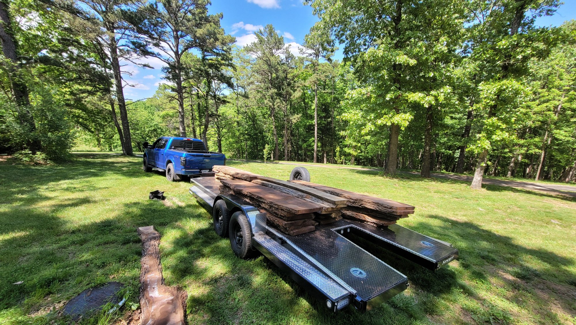

I've been very happy with my 2.7L (although with the 6R80). I've towed camper trailers, flat bed trailer, and enclosed trailers with no trouble. It honestly feels like there's nothing back there most of the time. Your gas tank feels it more than anything.
