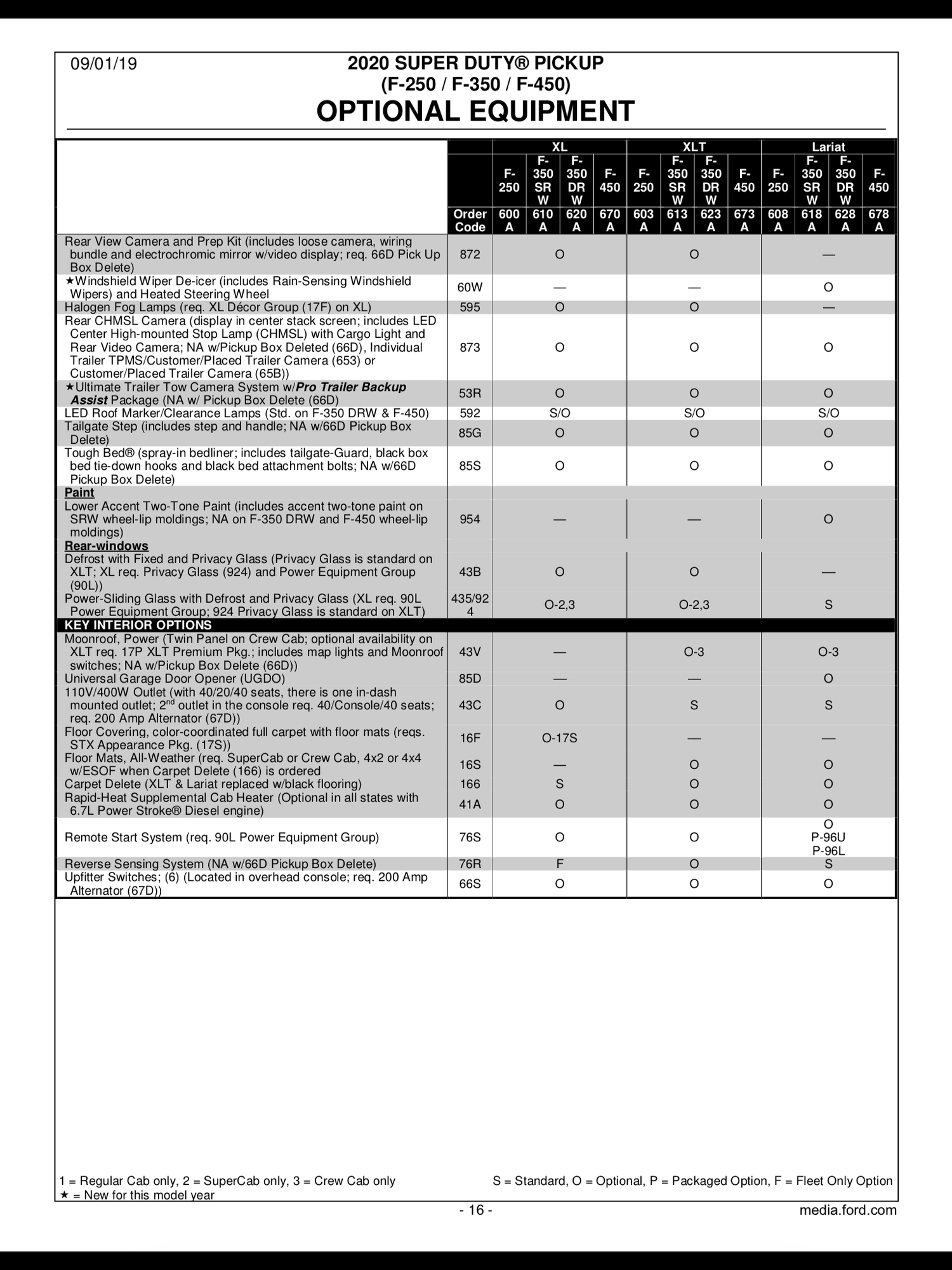

Originally Posted by nick112288
I'm confused what you have to add to the Lariat to get it? I don't see a windshield de-icer as an option on the online build tool
It’s option code 60W; see below. The good news is this package appears to be available an all Lariat trim levels, and therefore not just crewcab configurations.
HTH,
Jim / crewzer
