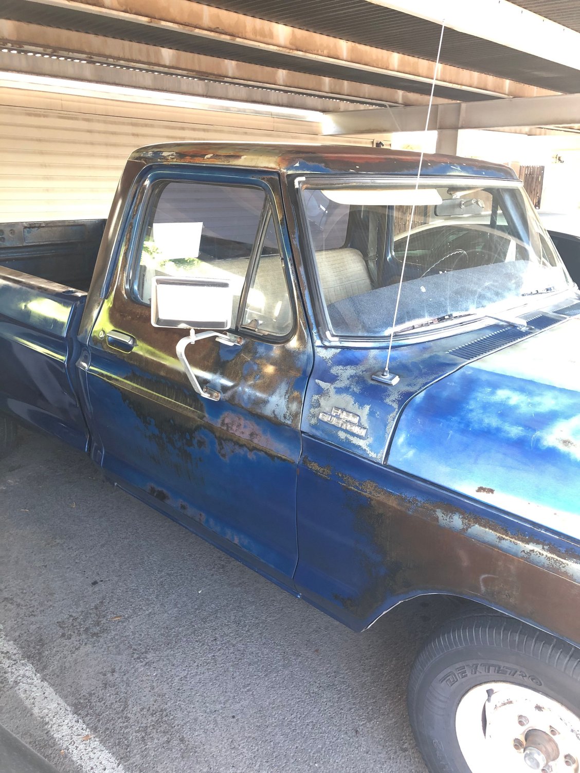

Looks like someone cleared over a truck that needs a paint job don't know why they do that?

Nope wasn't cleared! I just put a little shine juice on it. It could definitely go for a paint job, I was just trying to sparkle her up a little bit. Plans wise not sure. Throwout bearing is a little rattly, and i'm getting some chatter in "2nd", so i'm sure a clutch will be next at some point.

Ok from the picture it looked like clear. As you could tell I am not part of that fad of clearing over a truck that needs a paint job.
If you are going to spend the time and money to do the clear just paint it! That is what really shows your skills.

Ya it definitely shined it up. I won't be joining the fad of clearcoating a patina, I'll just save up to have it painted the factory dark blue. Nope located in Phoenix so the heater definitely wont be necessary. I'll try turning it on and see what sort of smell comes out. This was definitely black oil, just not a clue where it came from. Just drove a few miles and no new leak so I'm not sure. It only happened once. It had a makeshift carpet kit installed, and by makeshift I mean someone cut out a square of house carpet and bolted it in. I have since removed all of that and put down a couple rubber mats. Needless to say, the truck smells much better now.
