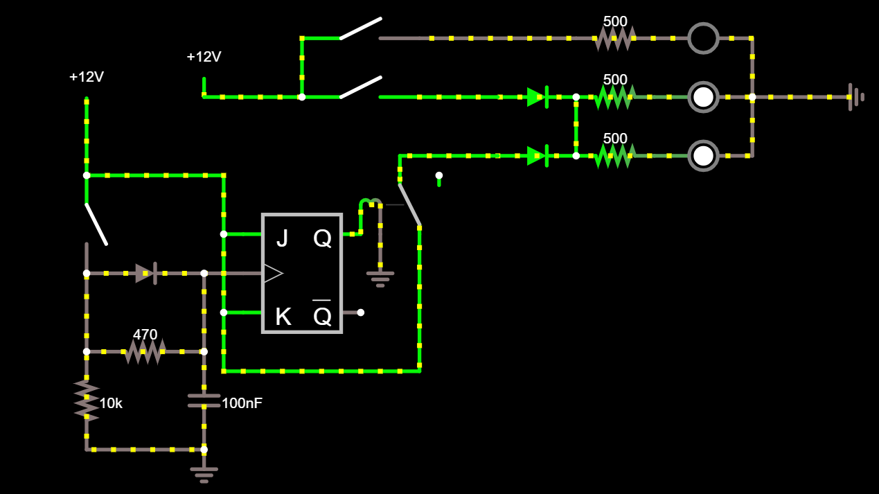

Progress
Well....I still haven't figured it out completely but I'm getting close. Turns out that if I want to be as **** and OCD about this as I want to be, I need a circuit attached to the headlight switch to bypass the BCM and go directly to the cargo lamps. This is all because I want to use the OEM push button to control the LED cargo lamps. So far, I only have a circuit in theory but hopefully I will be able to install it into the truck soon. If anyone knows anything about electronics I would love to hear your input.
The circuit on the top right is basically the high-mounted stoplight/cargo light bar. The very top switch is the brakes, the switch under it represents the BCMs control of the cargo lamps and the circuit and switch on the bottom left is the circuit that I need to build. I'll let you all know how it goes.

Hi, did you ever figure this out? I want to be able to use the rear cargo light on my private farm at night. Thanks in advance
