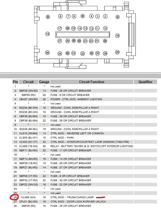

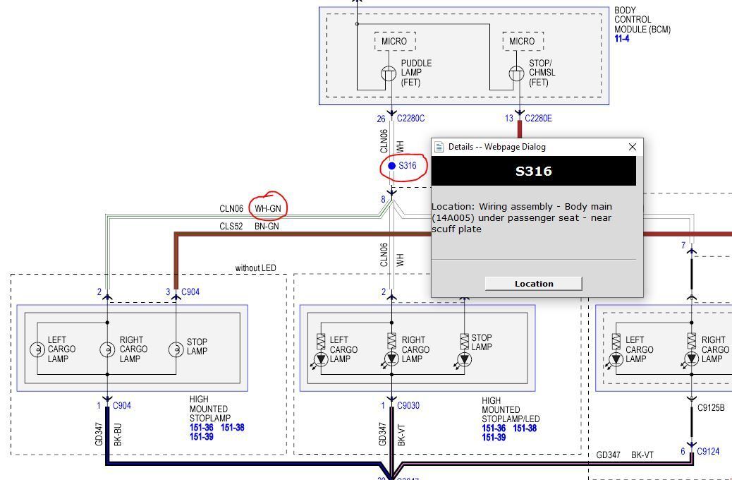

This is driving me crazy, can anyone please help me figure out how to turn on the cargo lights while on the road? Or does anyone have a wiring diagram that includes the high mounted brake/cargo lights? There has got to be a way to do this.

Looks like if you can find the connector (S316), you can apply power to the white/green wire (or white if you have LED's) to turn the lights on with a switch....or that's my way of thinking. Try at your own risk.

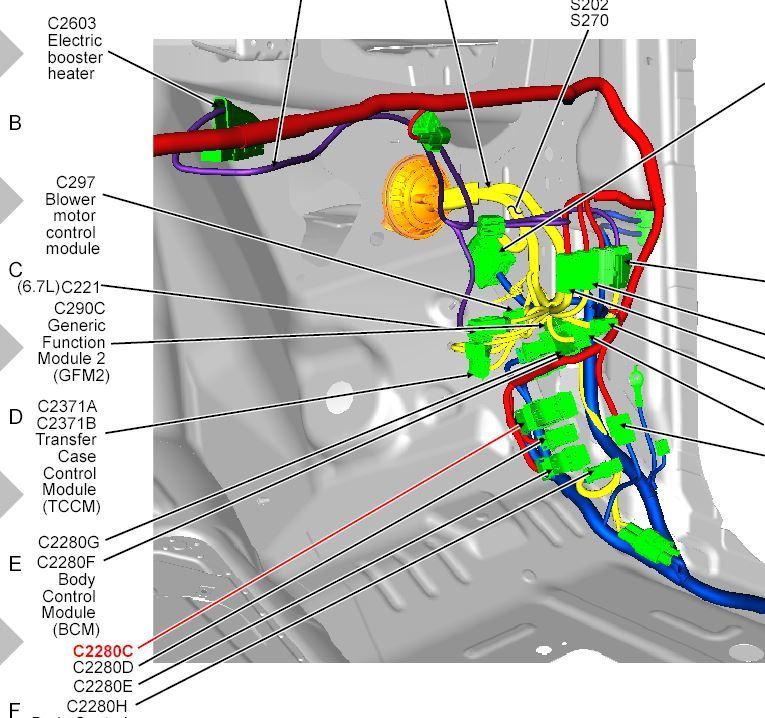

Or, you can grab the White wire coming out of the connector in the passenger side footwell:
This is all great info, thank you! I looked for days for these diagrams/CAD illustrations without luck. Where do you get these? I'll let you know what I do with it in about a week or so. Thanks again!
