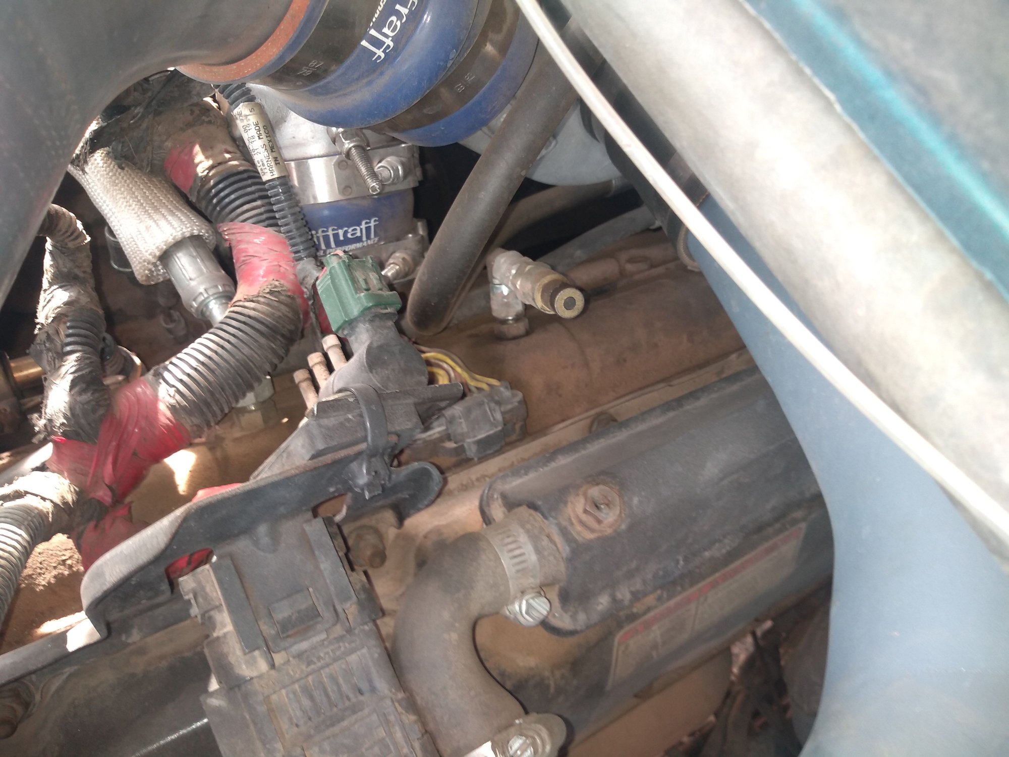

Looks like it is running an aftermarket hpop (adrenaline from diesel site). The oil crossover has been removed though. Any thoughts on why that is?
in the pictures you can see where the holes for the crossover have been plugged

The oil crossover is a non-essential piece that causes additional leak points for the oil system. Your Adrenaline HPOP probably has the check valves removed from the fittings which does exactly the same thing as the HPx (oil crossover) is said to do, but without the additional possible leak points.

Not listed in your build list but you've got a nice fuel bowl delete and regulated return setup there too. Do you have a fuel filter on the frame rail down by the pump?
Do you know if the H2E is a VGT version?
I wonder if what looks like a deleted HPX are actually valves to bleed the oil galleries. There's a similar looking valve on the FPR.

Good to know about the HPx Sous, yeah I about crapped my pants when I found the build sheet for this thing.
FordNoob no I don't think it's a vgt version on the turbo.

And yes it's got the fuel filters on the frame, you're probably right about the fittings on the head and regulator. That's a pretty cool feature if that's the case.

Looks like PO installed a lot of sophisticated custom stuff there. Divorced intake instead of spider, quick disconnects at oil rails, etc. Don't change anything until the situation is fully understood.
