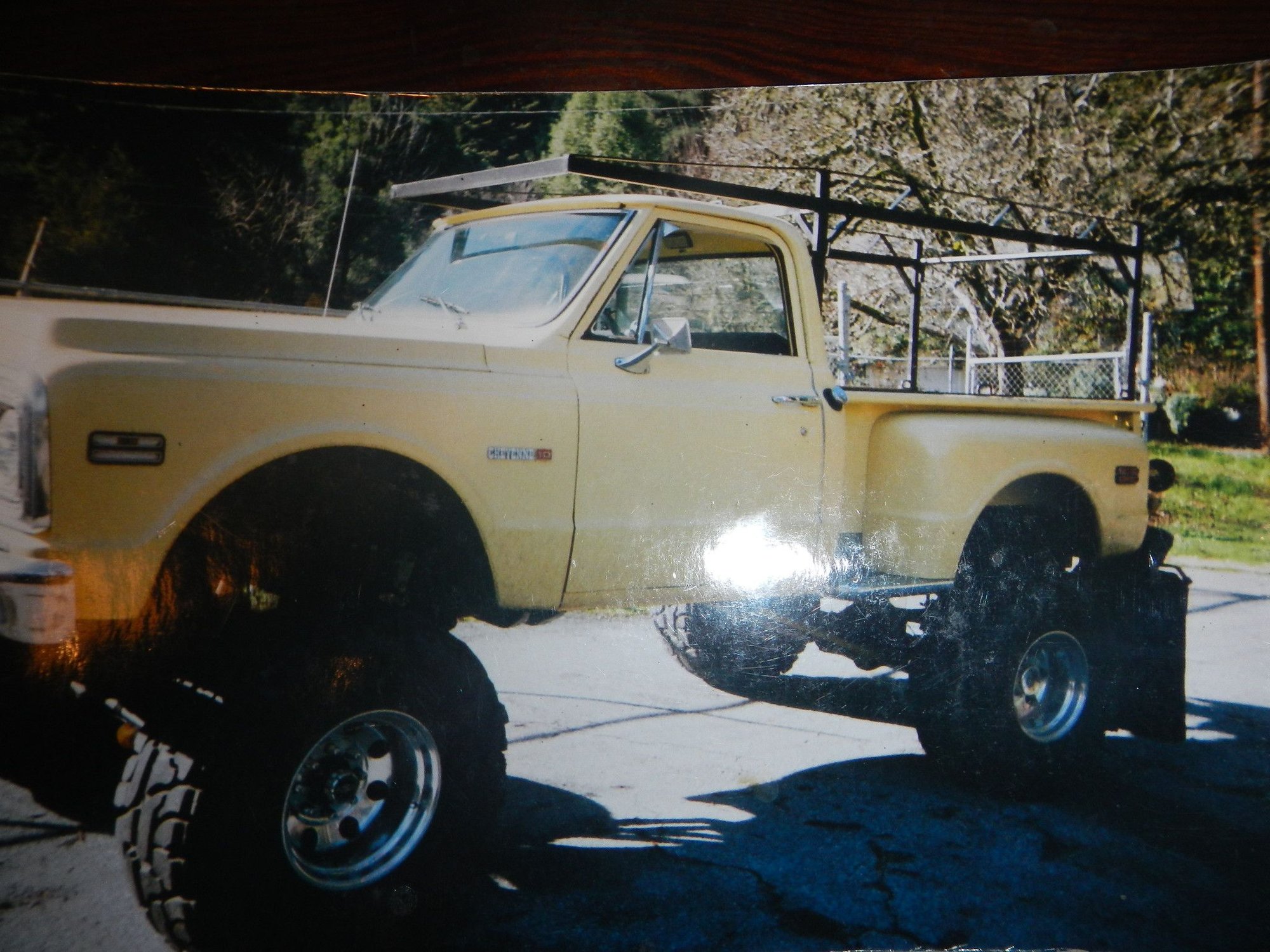

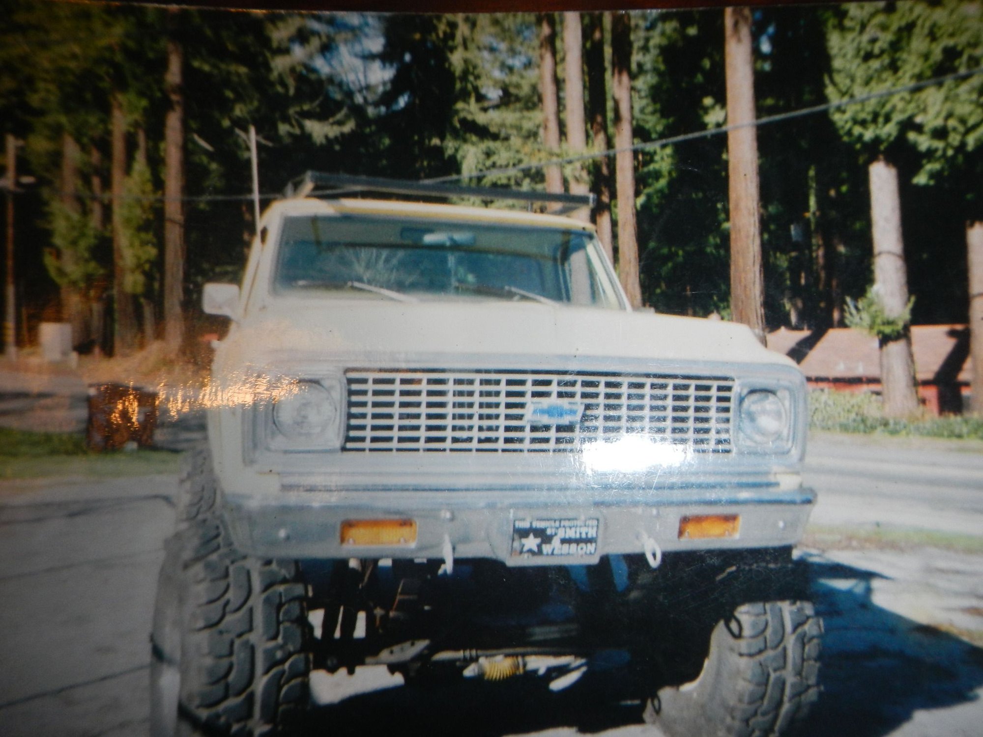

40 inch tires? What purpose are you trying to accomplish? I went that way back in the 90's. Big axels, big tires, big motor. In my opinion now I ruined a really good truck. 3 mpg, rode like a tank and took a football field to stop at freeway speeds. It took $$$$ to get it where it was no fun to drive, Looked super cool. I know this is a Ford site but I'm trying to make a point that some things don't need to be done. I sold it not long after , all that's left are these pics and less money.
