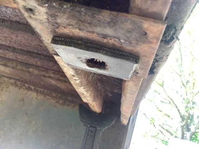

Mine have thin metal plates with a thin rubber layer (like inner tube tire rubber) between the plate and the frame that "I'm told" were used to level the bed to match the bed lines on the cab lines. This is the underside of my '64 Styleside short bed. You can see the thin sheet of rubber still stuck to the rear mounts on the first picture.
Doug

Looks like that was fun to get loose!

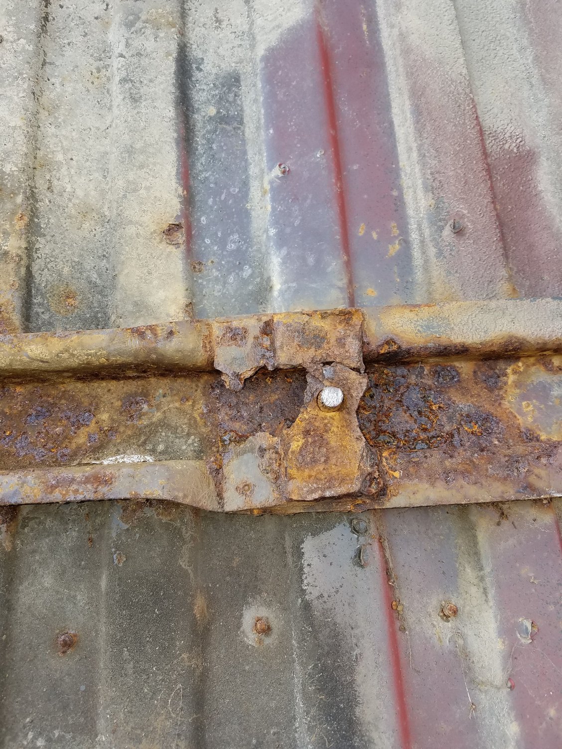

I took the box off a 1966 styleside SWB truck today, below is a picture of the rubber material between bed cross supports and frame

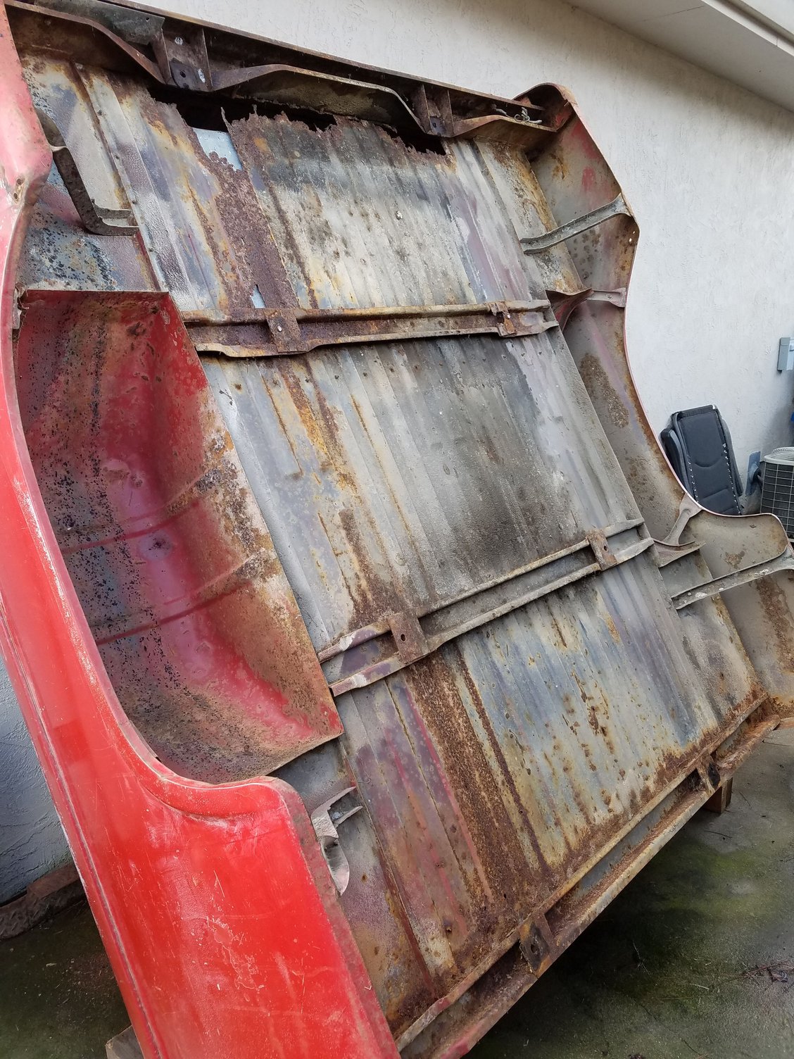

rdixiemiller,
It was quite the process getting the bed off the truck. Hours of trying to wire brush the threads of the bolts, soaking them with penetrating oil, busted a few knuckles and finally said forget this and used a cutoff wheel. I should have done that in the first place since I'm using new bolts to put it back on with, duh! Now to clean all that up, treat it and paint it after cutting the floor of the bed out completely. I'm replacing the floor with 1/4" diamond plate steel.
Doug
Ok, I can work with that. Thanks for the pic!
