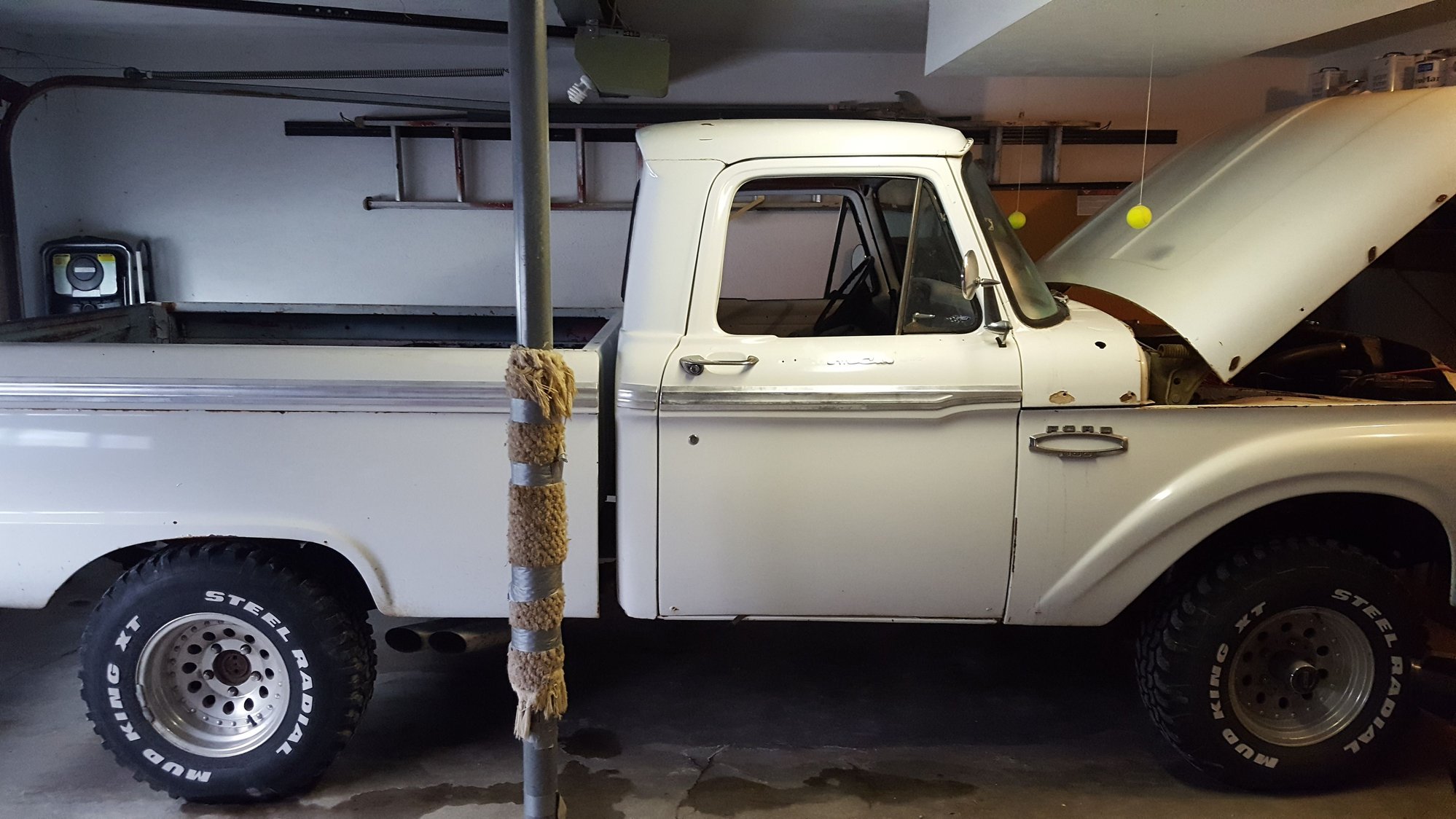

Here is a 66 shortbed on a 79 chassis...

You don't have to imagine anything, it's two inches longer on the shortbed wheelbase starting in '73. That's why the photo I posted of the '66 shortbed body mounted on a '79 shortbed 4x4 chassis has a larger gap between the bed and cab.
