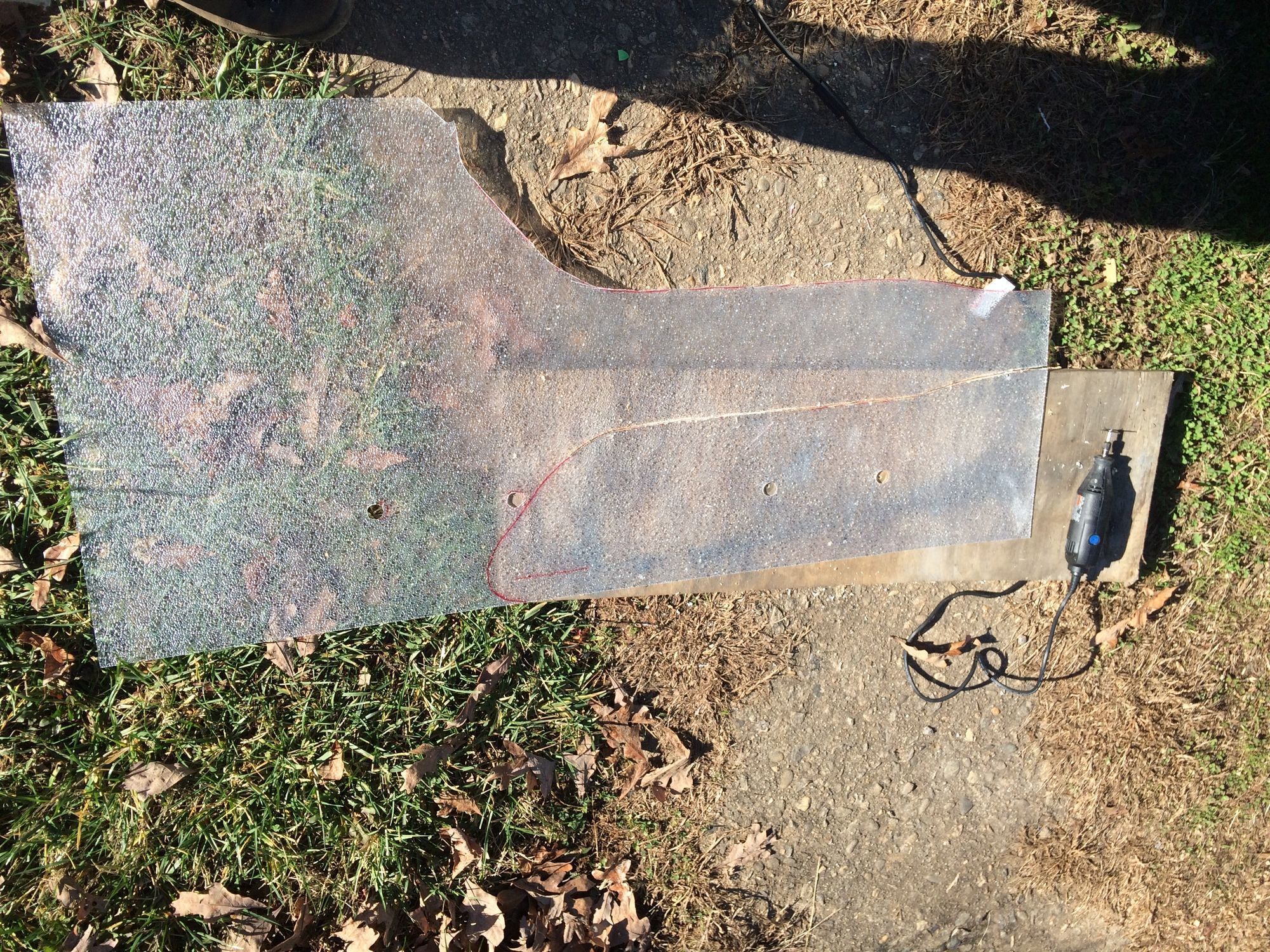

Would you be willing to provide a pic of your handy work please?

I cut the stuff with a dremel after marking outline with a sharpie

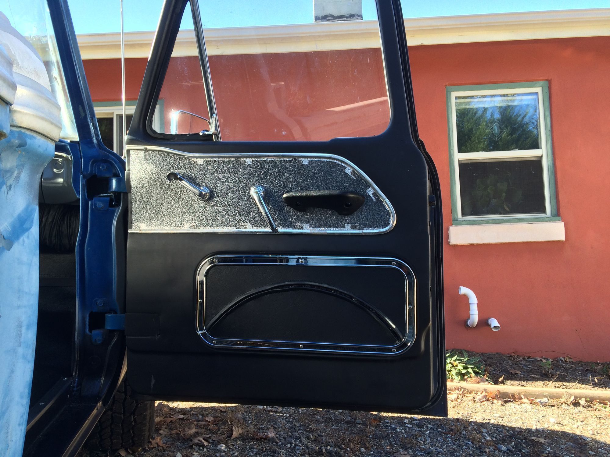

here is the panel installed prior to adding padding and vinyl

Great idea Gavin. That will work for a simple man like me. I kind of like the look of the panel as it is in your pic.

Thanks for posting the pics!

Here is the panel installed after adding some upholstery padding and a gray vinyl cover to match one of the two tones in the seat cover

Looks great!
