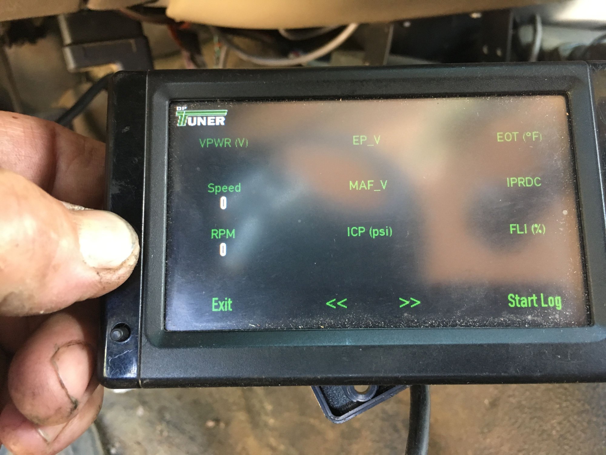

Long story short. In 2015 I had to have a shop do some work to my truck while on a road trip.
They installed the tuner. Only drove the truck about 4k miles over the next 3 years or so. "Trucks only seen 6000 miles in 5 years."
Hook up the toy hauler for a trip, get the wife, kids and dogs all loaded up, go to load my tow tune and it won't start.
Jody SAVES the trip and emails me a stock tune to load and get her going again.
About a year later I follow up to get my 12 tunes reloaded.. John at Emotion emails me the tunes and I load them to the memory card. Try to load them in my truck and nothing.
Got pissed and never followed up.
​​Ready to start towing and driving her again regularly and tried to load the tunes, again.
No go. It shows my tunes are there, but won't load them. Says I need to reload stock tune...
Ideas? Hardware issue? Software issue?
or dumb old man issue?
Emailed E-motion. Waiting to hear back.

Check how the tuner chip fits on the PCM J port. Pull the PCM out and see if some corrosion set in. Clean with a pencil eraser. Pics if you can so we can get more eyes on the problem.
I'll check that today.

You have the USB port for the chip installed? If so use it instead of the monitor to reprogram the chip. That's how I've done mine over the years.
