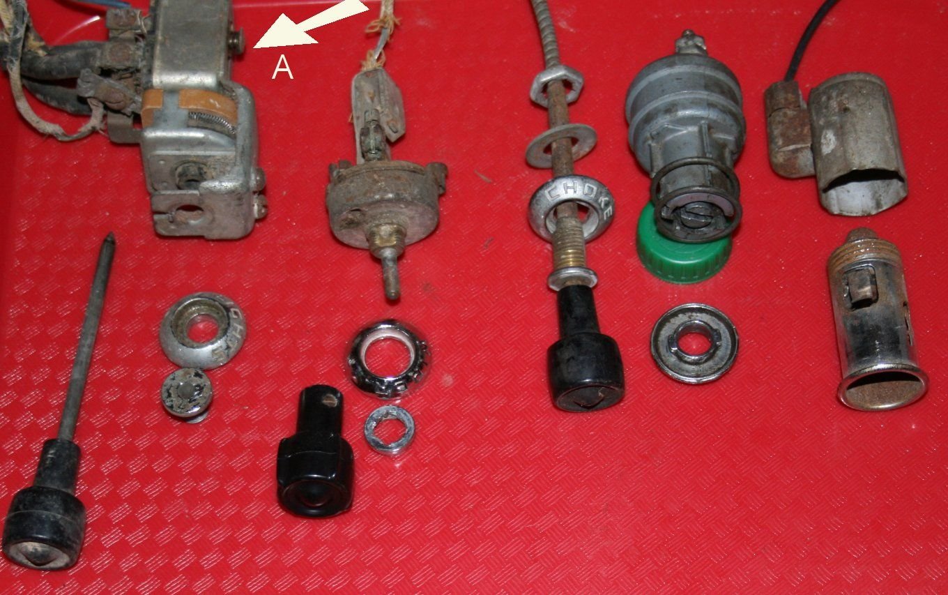

Here is a picture of the switches, etc., and their retainers removed, for reference.
The white arrow "A" is the button to push to release the light switch stem.
