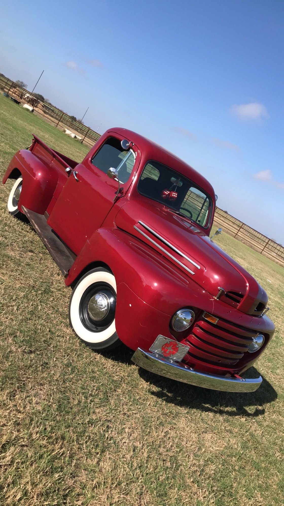

I swapped filters and cleaned them out could be clogged lines since fuel was running low. It’s still doing the same idles fine but if I keep it revved for a bout 5 minutes the in line filter dries out and the truck turn off. I wait a few seconds and it starts right up

Great looking truck. If you ever switch to an electric pump, get one with the correct pressure. All electric pumps are not the same. To much pressure will override your carb.
