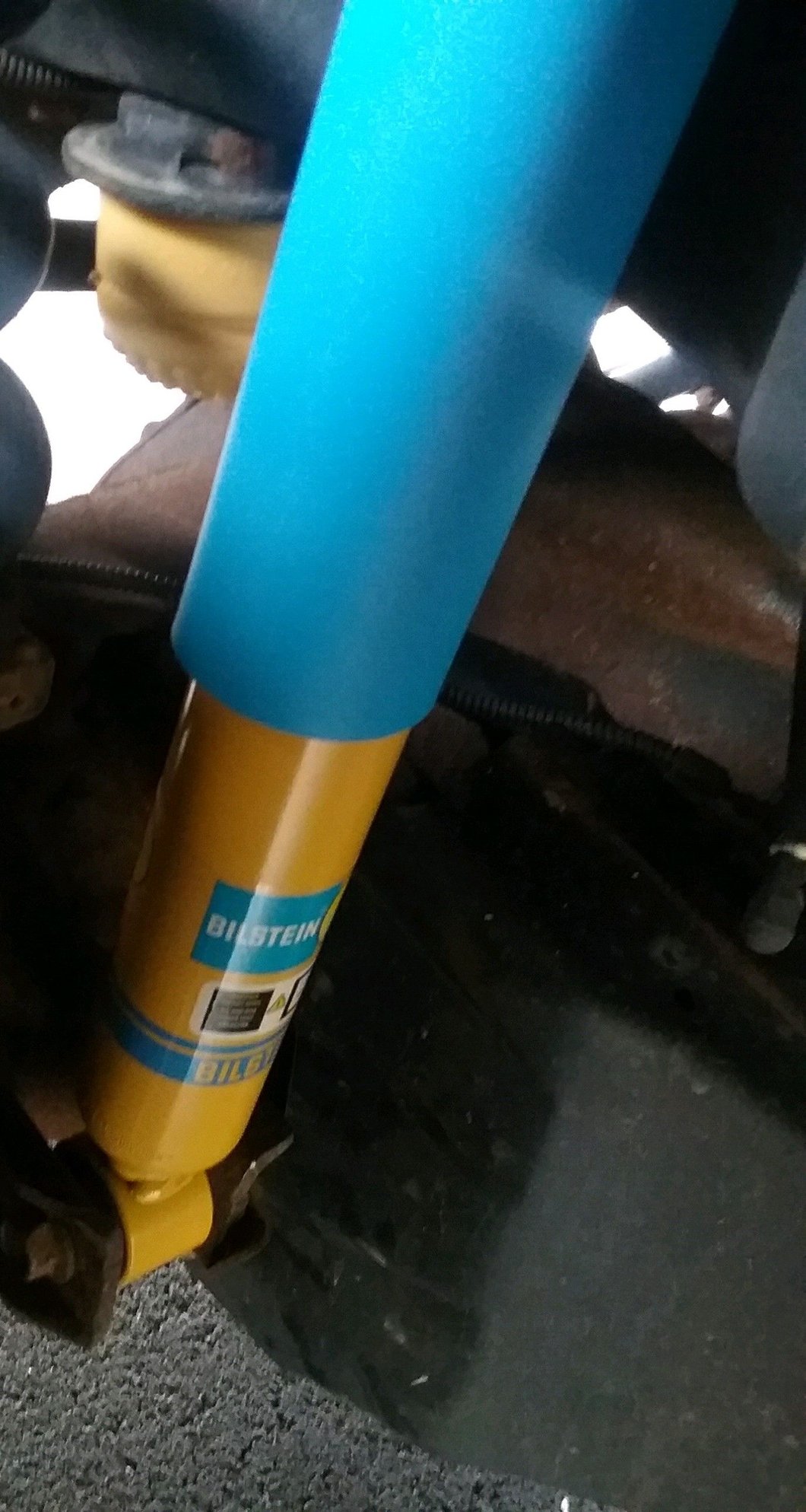

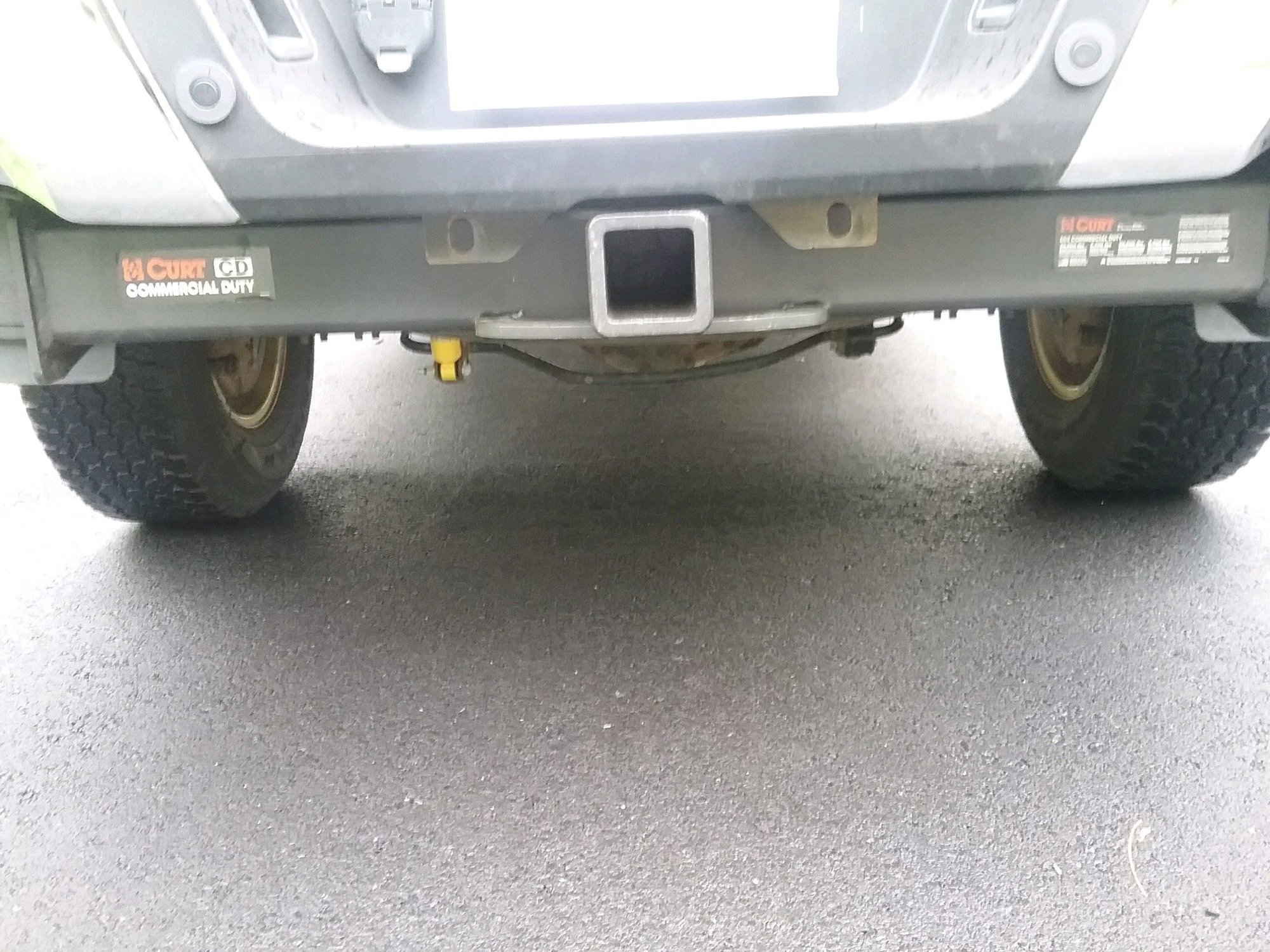

Here are pics of the shocks and the new hitch after install today....
I can already tell the B6 4600 shocks are "Softer" than the OEM Rancho's, which is easier on my old **** for daily type driving, but will have to report to you on how they handle towing when I hook up sometime in the future. As for the moment - I am pleased.
