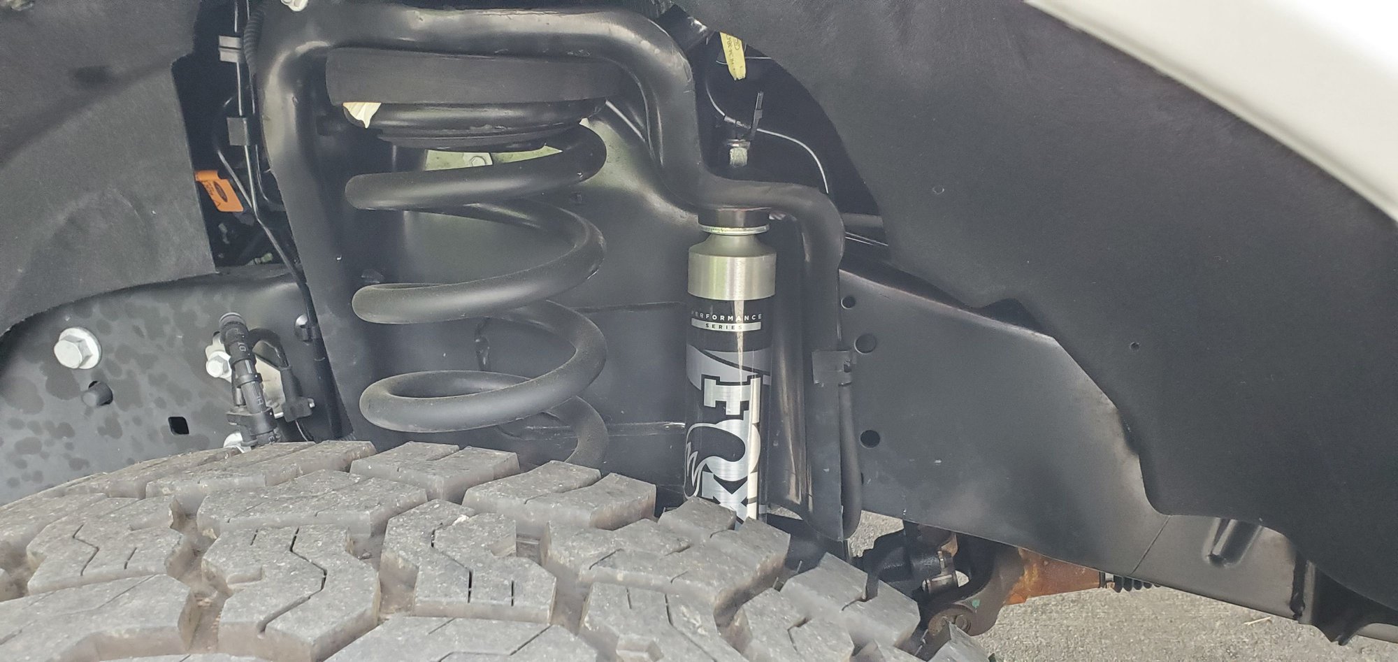

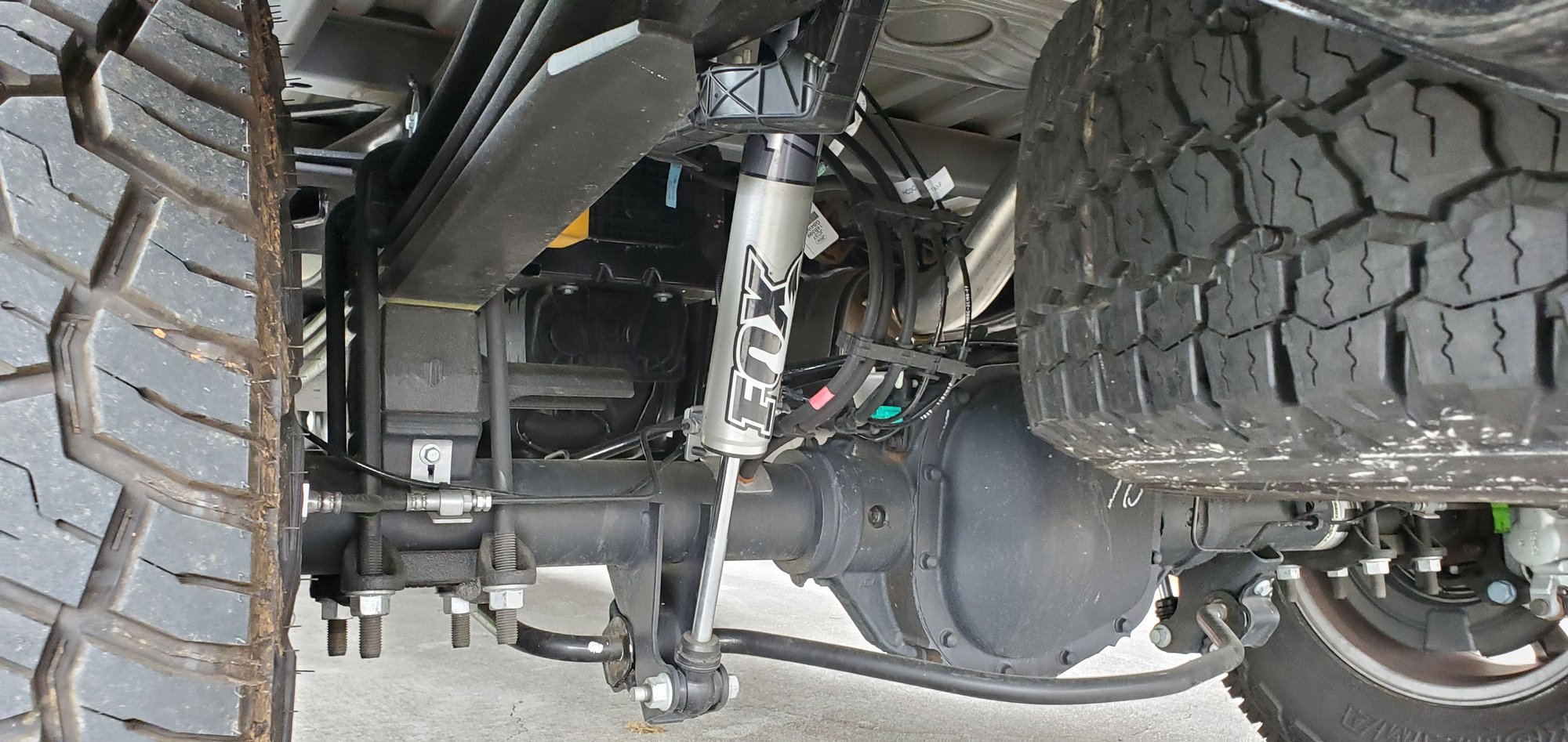

I had the opportunity to talk to a Fox tech on the phone. Since I rebuild my own shocks in my garage I liked the idea of being able to do that with their 2.0s. He explained it takes a special nitrogen filling tool specific to that shock to do that, and Fox charges $110/shock for a rebuild. Not really cost effective when new ones retail for $160. When you get into their off-road tailored shocks with reservoirs they are easier to rebuild. He said they use a progressive (gets stiffer as shaft speed increases) valve stack philosophy, but put a fair amount of float in there to still absorb the pavement cracks and small chop. He said they also put a significantly stiffer rebound valve stack in their truck shocks to control the very stiff springs that HD trucks have. They are normally tuned 90/10 for street/off-road use. They have aluminum bodies so they won't rust, but they can still get corrosion over time. They don't come with any sort of shaft protection.
I ended up going with the Fox 2.0 option. I liked what I heard from Fox and agree with their valving philosophy. I don't drive my 450 daily and if I have a load on it I want the extra damping capacity. Especially with the very limited travel the front end has. The nitrogen charge pressure in these is much higher than any other over the counter shock I've seen installed, and you will need a floor jack to push them up into place after you cut the straps. I do not recommend trying to stick the bolt through as it's extending. Good way to lose a piece of skin on the rear in the line-up process and they put the hardware on the front pin tops under the strap. I had some extra Rancho boots lying around that I put on my shocks to protect the shafts from the chloride they put down on the winter roads around here. Bought my rears from CJC Offroad for $150/set and found my fronts on Amazon for $120/set. My stock FX4 Ranchos were toast so I can't compare to much, but so far I like the Fox ride. No more blowing through the travel, ok on asphalt cracks, no more excessive rear end hop on uneven road surfaces (bridge edges, changes from asphalt to concrete). Still need to test with a heavy loaded trailer. Snowmobile in the back and small enclosed trailer is all it's seen so far.
