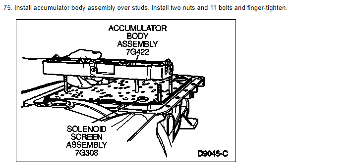

This is the pictorial i get from the factory manual. no plate between the main gasket and the accumulator body.

In stock factory form, there is no plate used.
Old Apr 29, 2020 | 02:24 PM
Mark Kovalsky's Avatar
Mark Kovalsky
Frmr Ford Trans Engr
Joined: Aug 1999
Posts: 24,730
Likes: 2,658
From: SE Florida
Then that's the way to put it back together.
