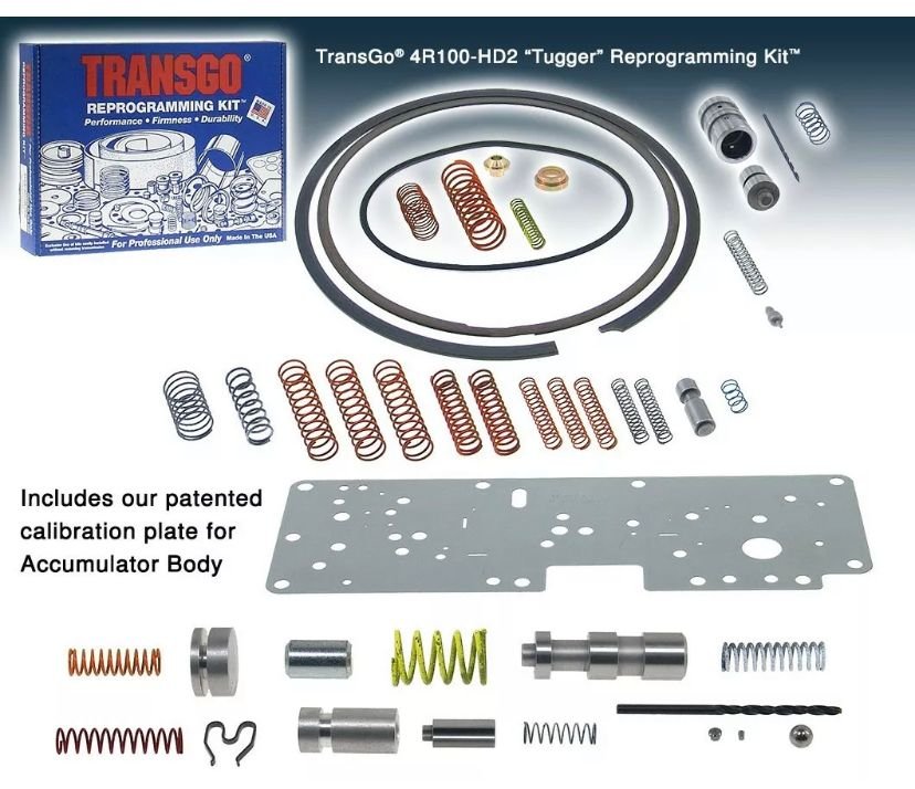

Mark, since I replaced the transgo springs and valves with sonnax parts essentially making a sonnax accumulator body shift kit, should I remove the calibration plate? I notice all the other shift improvement kits do not use a accumulator body plate.

I guess I don't know what an accumulator body plate is. I thought you were referring to the separator plate. The trans won't work without a separator plate under the accumulator plate, there will be too much leakage.
It’s the plate in this picture
Old Apr 28, 2020 | 01:42 PM
Mark Kovalsky's Avatar
Mark Kovalsky
Frmr Ford Trans Engr
Joined: Aug 1999
Posts: 24,730
Likes: 2,658
From: SE Florida
You need either that one of the original.
