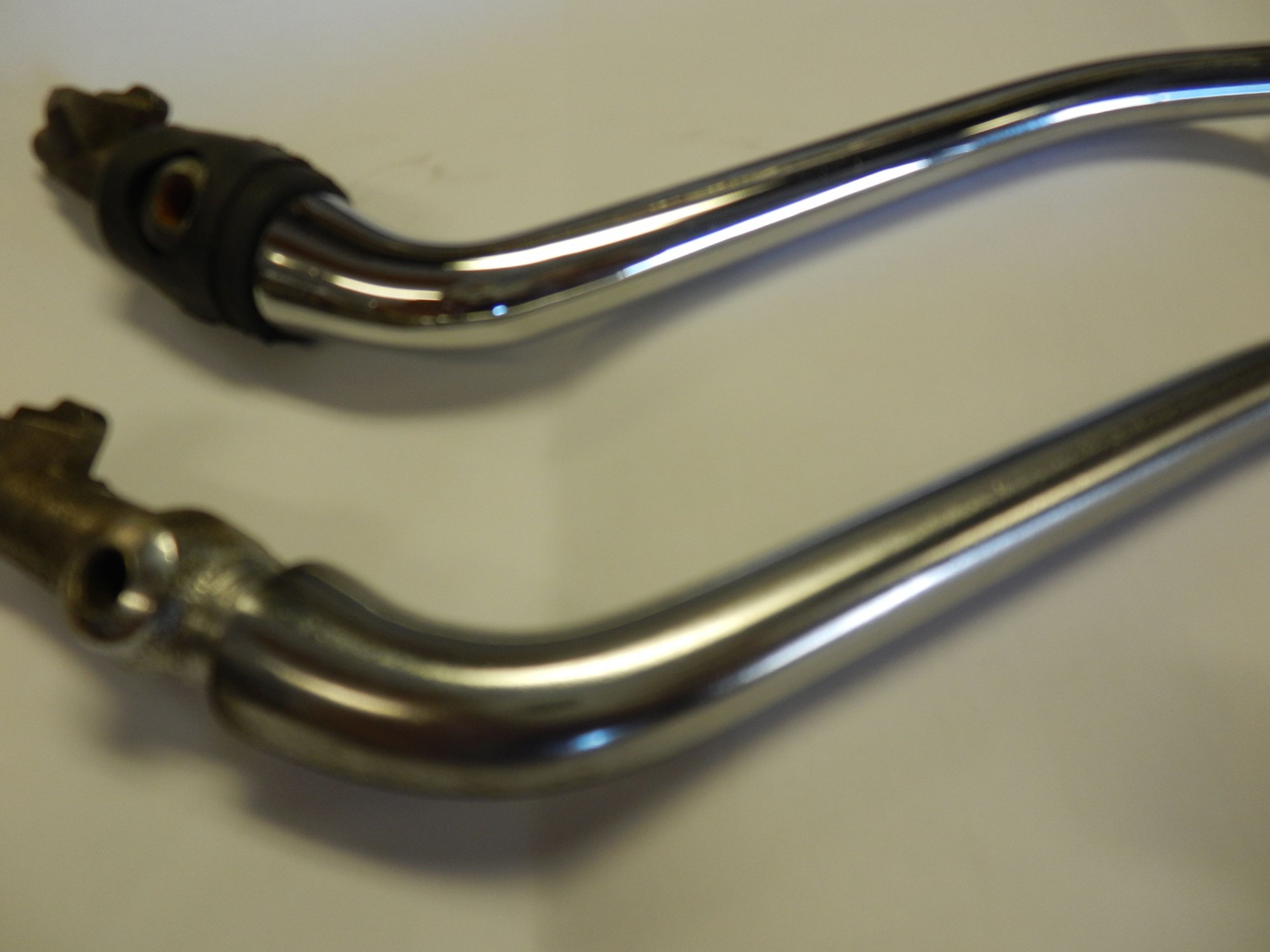

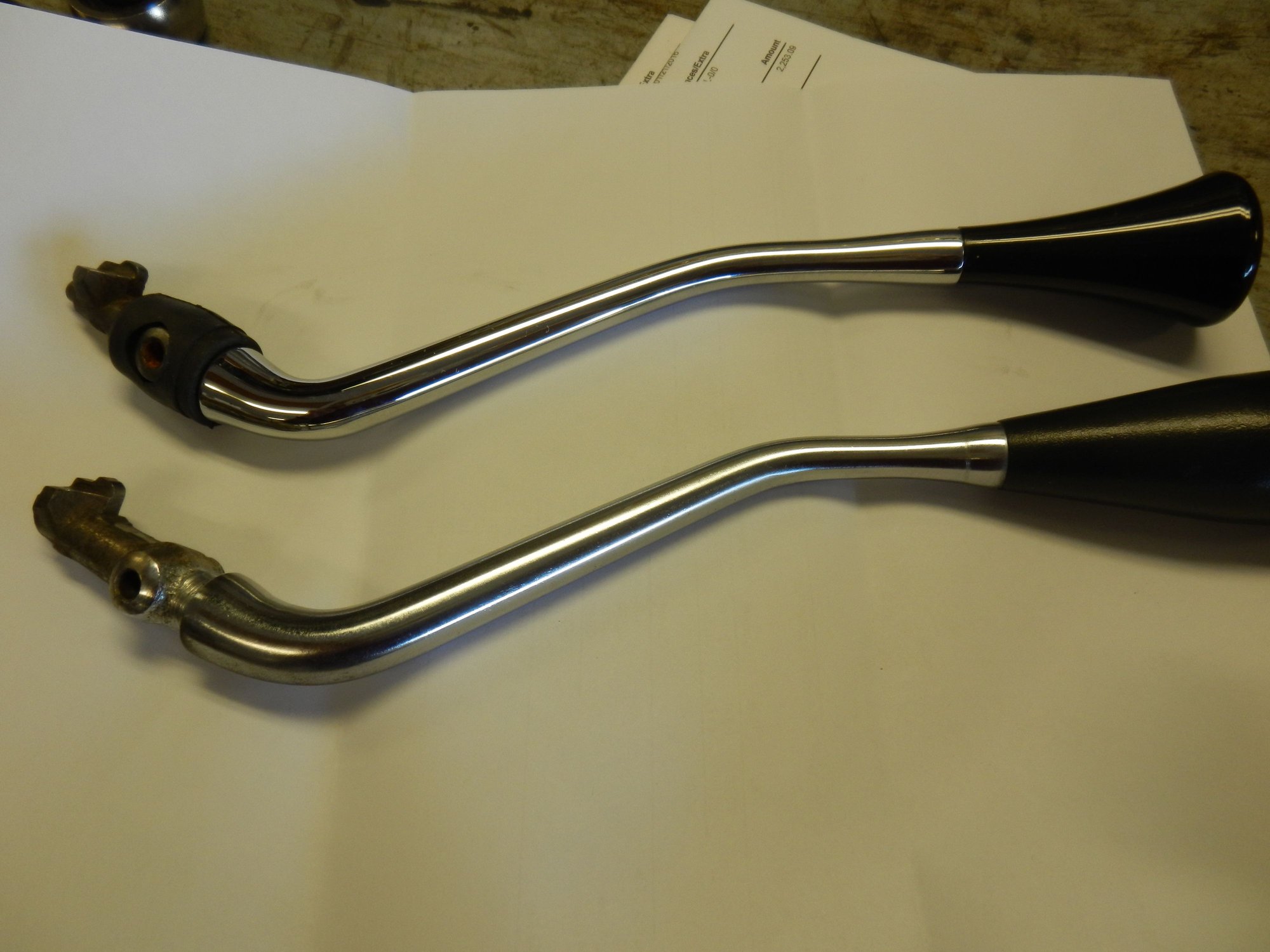

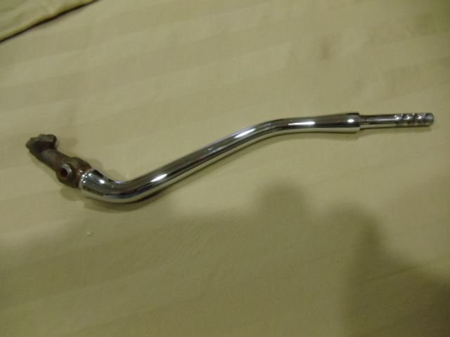

Does anyone have a source for the automatic shift lever (on the column) for the 72-77 trucks? I cannot find one to save my life. I am trying to find a good photo of one so I can see how much the engagement tab on mine is worn and if I need to replace it. this thing will shift well when I am done with it come hell or high water!! ha!

Don't know if this will be clear enough to help you. This is one that I took a picture of after I got it back from the rechromers. I'll see if I have a better picture.

Here are a couple of more, again, don't know if they're clear enough to help.
In both pictures, the lower gear shift is a brand new NOS replacement from Ford.

That's super helpful Mike! I was trying to get an idea of what that engagement "tooth" profile looked like from the factory. Mine is rounded off on the edges, but I was worried that step down notch was not factory. ha!

Thanks for the parts picture. We are looking for Selector lever Assembly or just the Automatic column shift lever. Found a couple used on Ebay but haven't found any new in my search. CJ Pony has for 72 but **** area is different. We have a 74 Ford F250 4x4 automatic highboy under construction.
