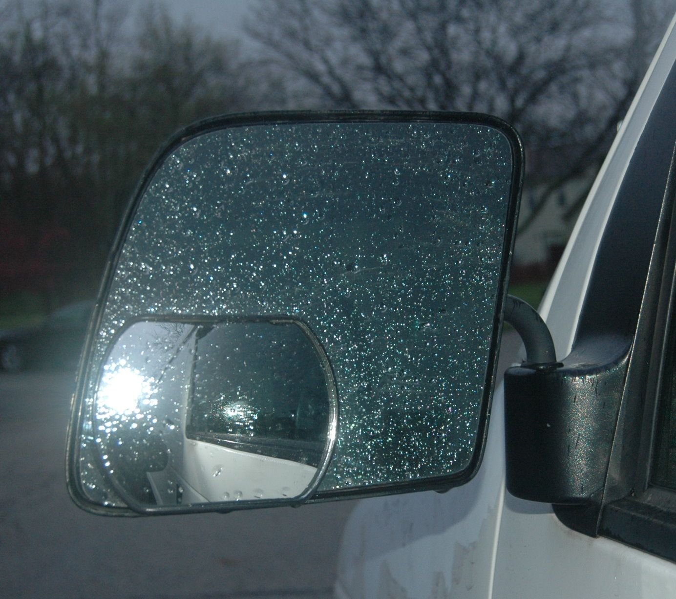

Beginning about 2003 I believe the mirror mounts changed---from the 3 stud to the 4 stud. As Jimbomitch says they're the same from 1992 to 2002 and then from 2003 to 2013 which was the last year of the full metal body E-Series.
Here's two photos showing the easily seen differences:
Even the extendable towing mirrors use the 2003 and later door shells FWIW.
HTH
