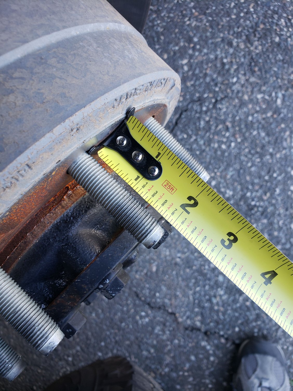

Alright, I had a little time this morning to check out a few things. First, my front axle it one inch wider than my rear (front = 64.5 inches, rear = 63.5 inches). This is good to know if you want to make your wheels exactly the same width with wheel spacers. Just gotta order 2 a half inch different from the other two. Second, my wheel studs in the rear measure exactly 2 inches. So if you do not feel comfortable cutting your studs, you will have to order a 2 inch spacer minimum. Third, I measured one inch for the stud sticking out past my wheel (sorry no pick of that). I hope this info helps others. I think I may wait on wheel spacers until I get wider tires (35x12.50R18) and see how she sits then.

Thanks. Did you happen to check if the front studs were also 2"?
No, I did not. I am 95% sure that they are though. There's no reason why they shouldn't be.

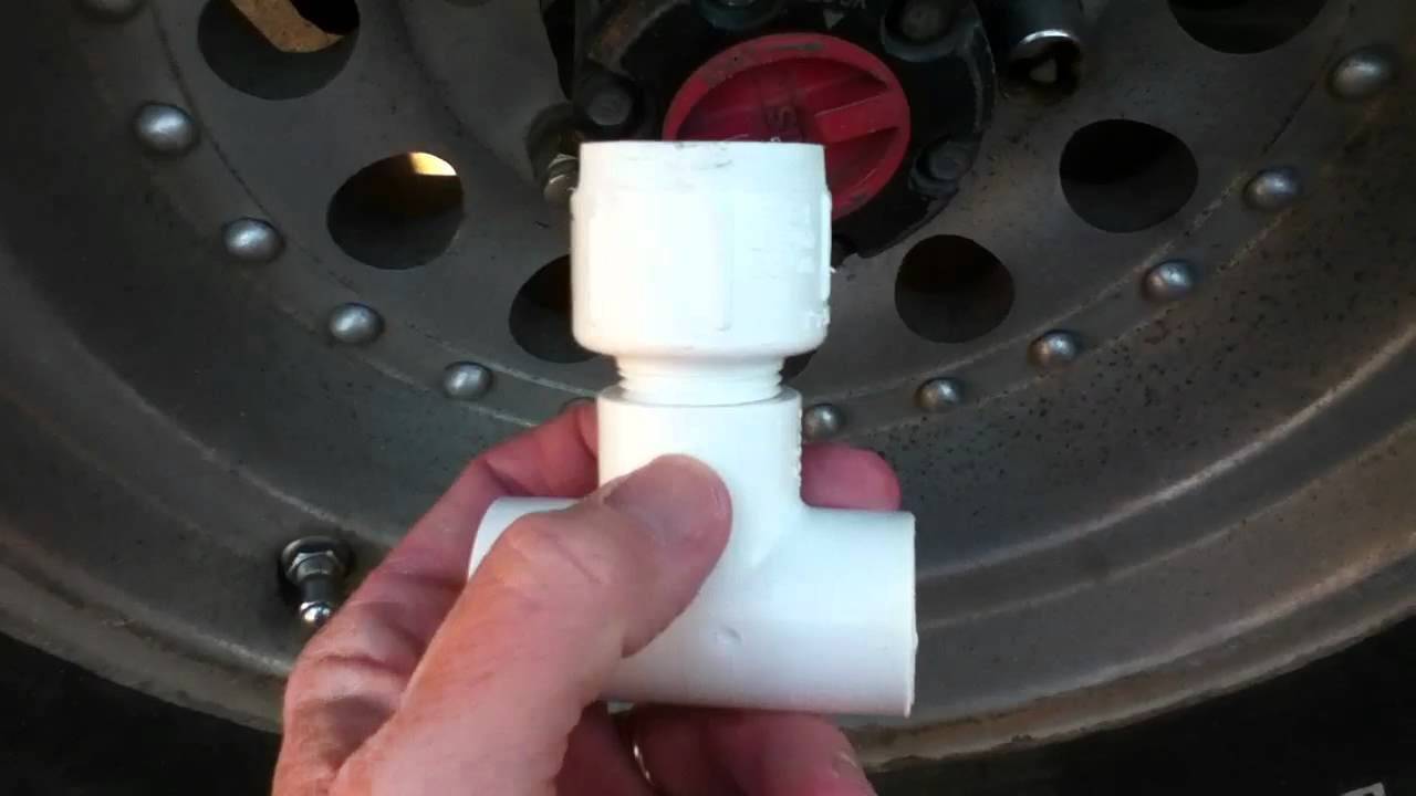

This is one thing that I keep thinking about. How much of a PITA is it to twist the locker?

I have WARN stainless lockouts, so the turn pretty easy, also they come with a little tool to assist (I guess for the limp wristed types) that also helps if needed. Or you could make one like this from PVC to keep in your glove box.
