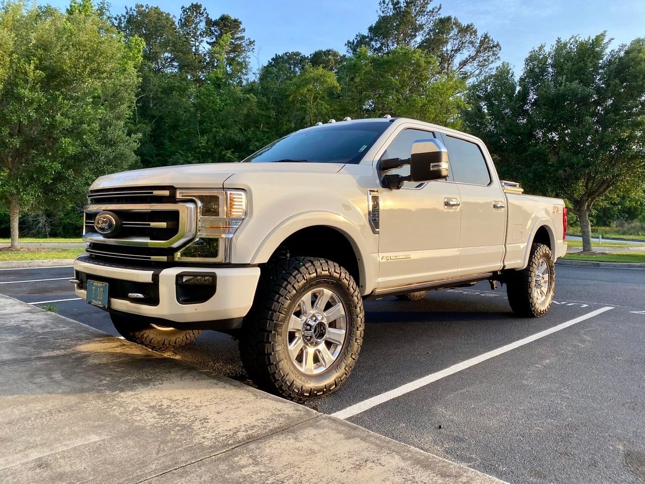

2" BORA here. If you have the M275 axle, you cannot use their hubcentric spacers on the rear.

Good lookin truck! I love your front license plate, my initials are W.S. Where did you get it? Also, how do I know if my rear axle is an M275?

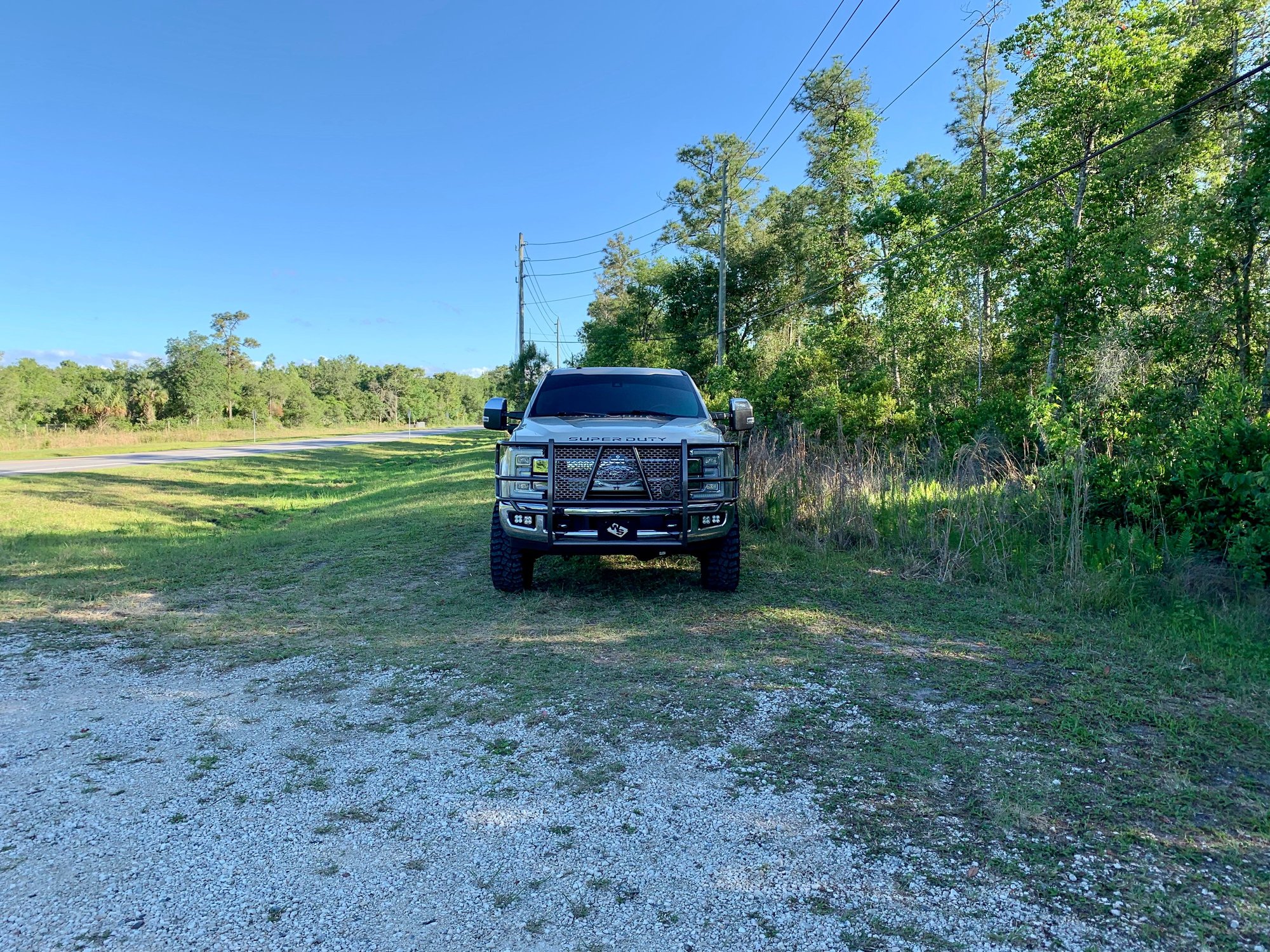

Looks good, happen to have any shots "straight on" from the front or rear?
From my understanding on 250's if you have the heavy duty tow package you have it or if you have a 350 SRW. It is a company plate.
I can take a couple for you this afternoon.

Not sure what all you wanted. Here’s a few.
Curtis
