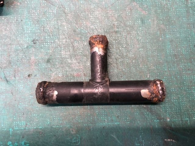

Might as well replace what look like original 160k hoses, right? I've ordered Gates replacements ( would prefer Motorcraft, but you know why I can't ) for the upper, lower and lower connector from the degas bottle ( got a new one of those too, as it looked cracked at the glue joint ). My question now looks toward the heater hoses, which normally are bulk 5/8" or similar. But my truck has a swaged Tee arrangement on one of them, and I can't seem to find it for sale as-is, though I can build one. Anyone done this?

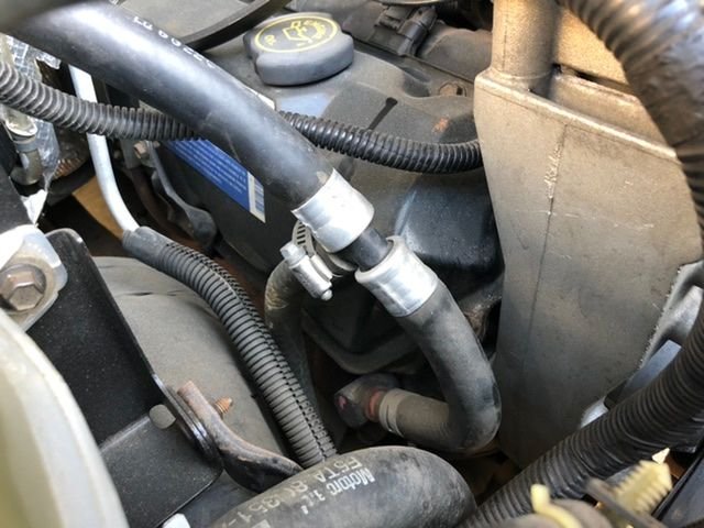

Shoot us a picture of the heater hoses.

I know which one, the one that goes from the bottom of the radiator, to the heater hose to the passenger side head. I bought a brass T and had my local hydraulic supplier to crimp my provided heater hose, its been on there for at least 9 years

So no problem with the banded heater hose tee- I cut it off with a disc and was able to reuse the slightly rusty tee using normal hose clamps.

Where does that 'T' lead? My 10/95 built (96 MY) does not have that.

So the heater core Tee connects to the lower radiator next to the drain plug. Funny thing is the radiator bung for that hose connection has perhaps ( I didn’t measure it ) a 1/16” hole cast in it. So I’m guessing it provides some sort of pressure equalization within the cooling system.
