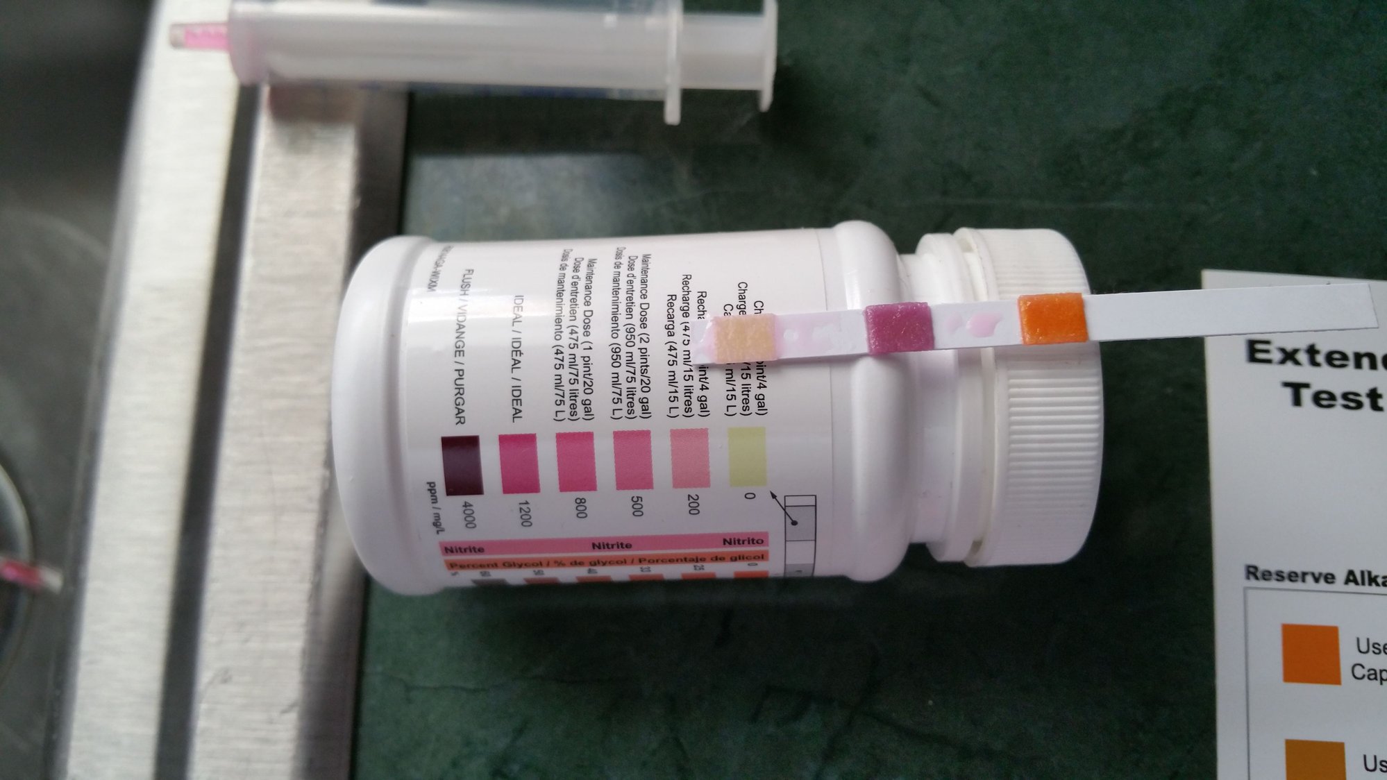

Old Jan 2, 2017 | 01:03 PM
Just Strokin's Avatar
Just Strokin
Joined: Nov 2001
Posts: 6,748
Likes: 118
From: Tallassee, ALabama
Originally Posted by zeroo
I have the kit also, but mine is a 2 step. It test for corrosion inhibitors but also for contamination.
Ford Rotunda 328-071ELC is the correct kit to test the ELC after checking with the strips for nitrates.
Here are photos of my test results
Old Jan 2, 2017 | 01:40 PM
Dakster's Avatar
Dakster
Joined: Dec 2013
Posts: 9,762
Likes: 115
Larry - That's the test my dealer used and I always passed after they realized they used the wrong one and added the wrong revitalizer to my 2011 6.7...
Which is what they were probably going to do to 2civicrr... Good catch 2civicrr...
