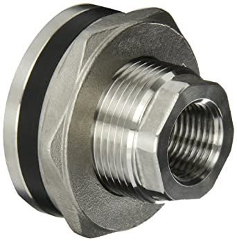

there is a number of different valves you could use.....
Problem with this is being it would be at the lowest part of the tank in the "Fuel Sump area" under the shower head ......driving over brush could be problematic.
on Aircraft it is Mandatory that the fuel sumps are drained on every Post Flight Inspection ...what this does is makes sure there is no fuel contamination and that the valve don't leak.
on our trucks I would suggest a Flange and plug instead of a valve that could get knocked off or leak as I don't see anyone crawling under regular to inspect it.
Maybe something like this....
of course it requires tank removal and it could still be struck by a road hazard, they do make flush mounted valves but they are stupid expensive.
BUT in a case like what happened to Tom, it would be nice as you cannot siphon a tank dry.
