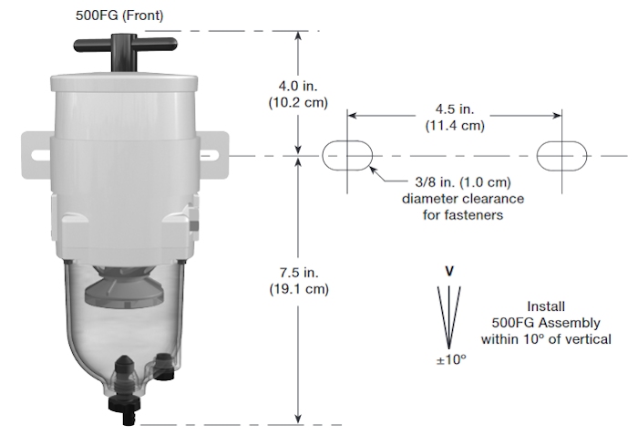

I have the Racor 500FG fuel water separator mounted in the area of where the
factory fuel water separator lived.
Here is a link what it looks like.
https://www.defender.com/product.jsp?id=133655
Pricy? Yeah but what it accomplishes will more than pay off in the long run if you
have your truck for a long time.
The market is flooded with the Chicom knockoffs in the $50 range. I would go with
the real McCoy.
